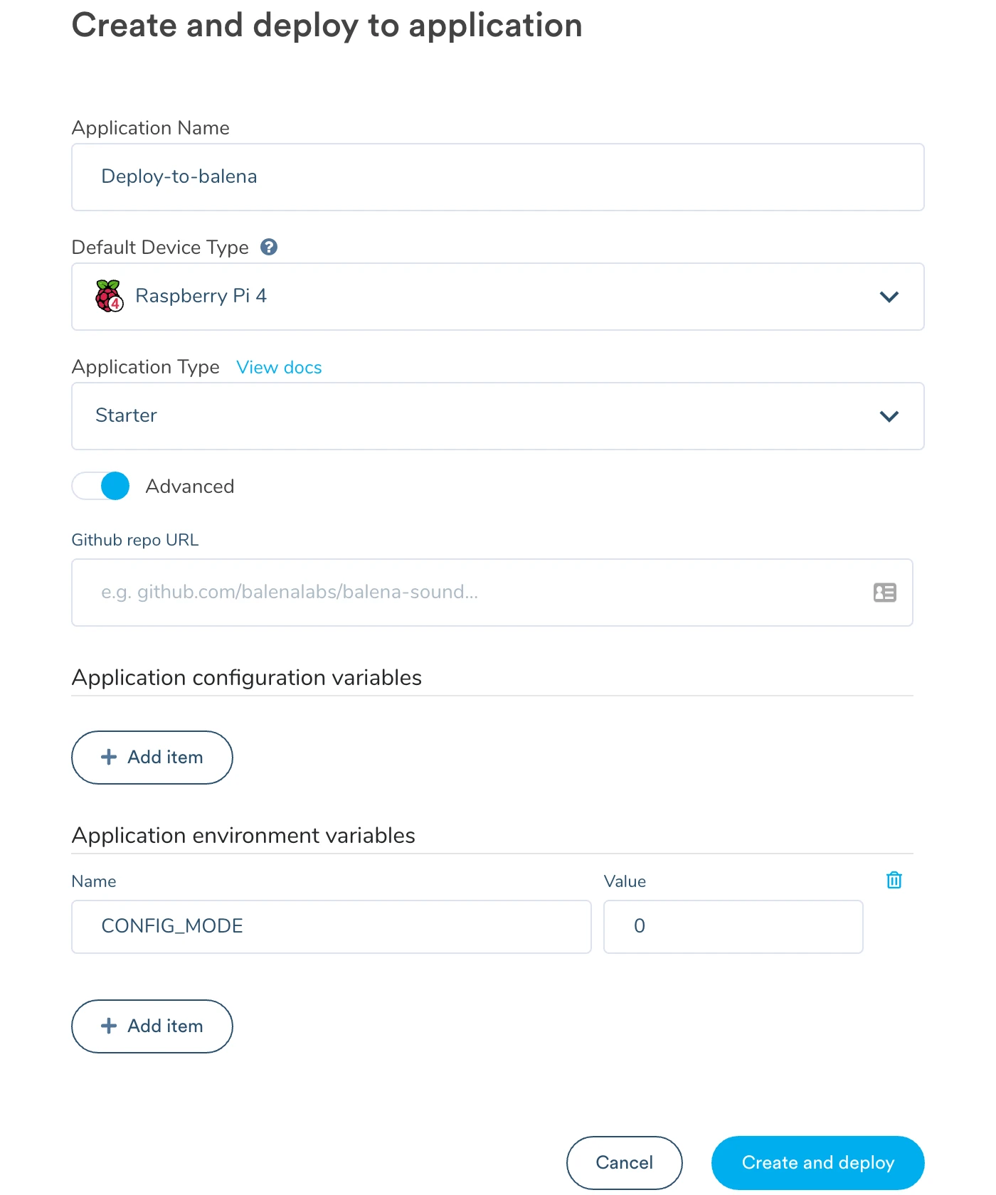

Clicking the Deploy with balena button opens the balenaCloud dashboard with a modal window pre-populated with everything required to deploy a fleet. Clicking the Advanced toggle in the modal window allows adding additional configuration options. If the project has provided configuration variables via a configuration file, then they are pre-populated in this section.
Clicking Create and deploy creates a new fleet and generates a release. Any devices added to the fleet will immediately download and begin running the release.
