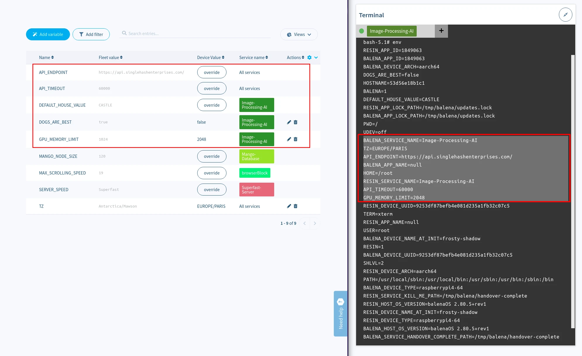

Variables defined in the dashboard are exposed on the device as environment variables and can be accessed within the service or services that they were defined for as shown below:

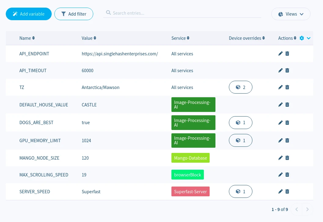

Fleet-wide variables can be found from the Fleet Summary page by clicking the *Variables* tab.
To define a new variable, click the *Add variable* button in the upper-left corner.

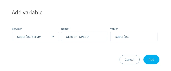

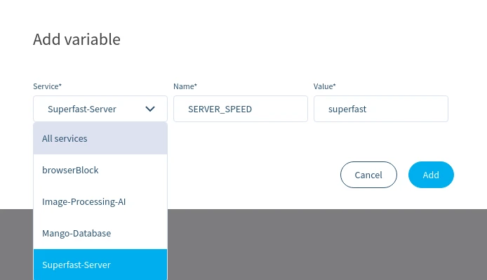

In the dialog box that opens, select either 'All services' or a specific service to which the variable will be applied.
Define a name and value for your variable. Click the *Add* button to apply the variable to all devices in your fleet that do not have their own values defined:

Your new variable will show up in the list, where it can easily be modified or removed. Adding or modifying fleet variables will trigger restart of all services on the device.

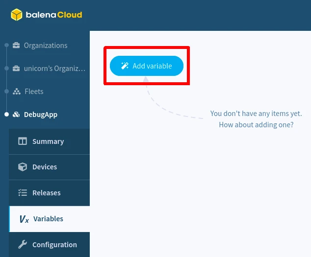

Adding a device variable is very similar to adding a fleet variable. From the Device Summary page, select *Device Variables* to open the variables page. Click *Add variable* to select the appropriate service or all services if necessary. Add a name and a value for the variable you wish to apply, and click the *Add* button to add the variable.

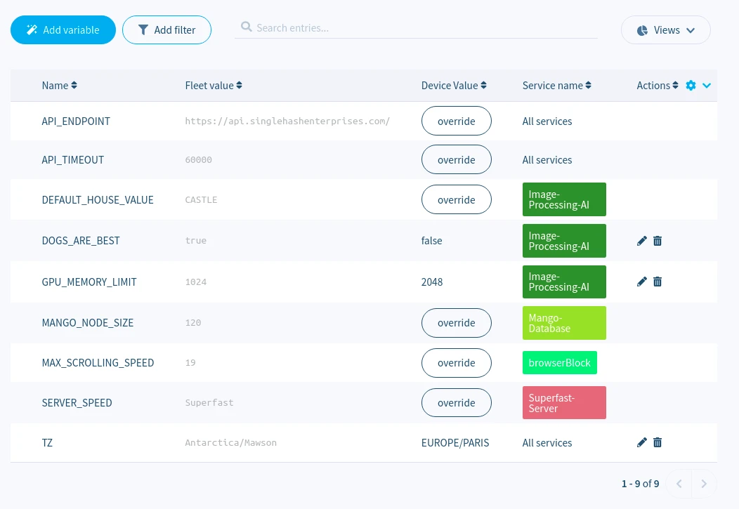

The variable list will include variables defined for that specific device, as well as any fleet variables of the same type:
<figure><img src="https://3346268949-files.gitbook.io/~/files/v0/b/gitbook-x-prod.appspot.com/o/spaces%2F8MXngJ2SifhuKl2pgGbI%2Fuploads%2Fgit-blob-4fb91d57746deca2ce9a1d84dd9506b26f73faf4%2Fdevice_variables.webp?alt=media" alt=""><figcaption></figcaption></figure>
You can override the value of a fleet variable by clicking *override* in the far-right column. This will pop up the variable editing dialog, where you can change the value:
