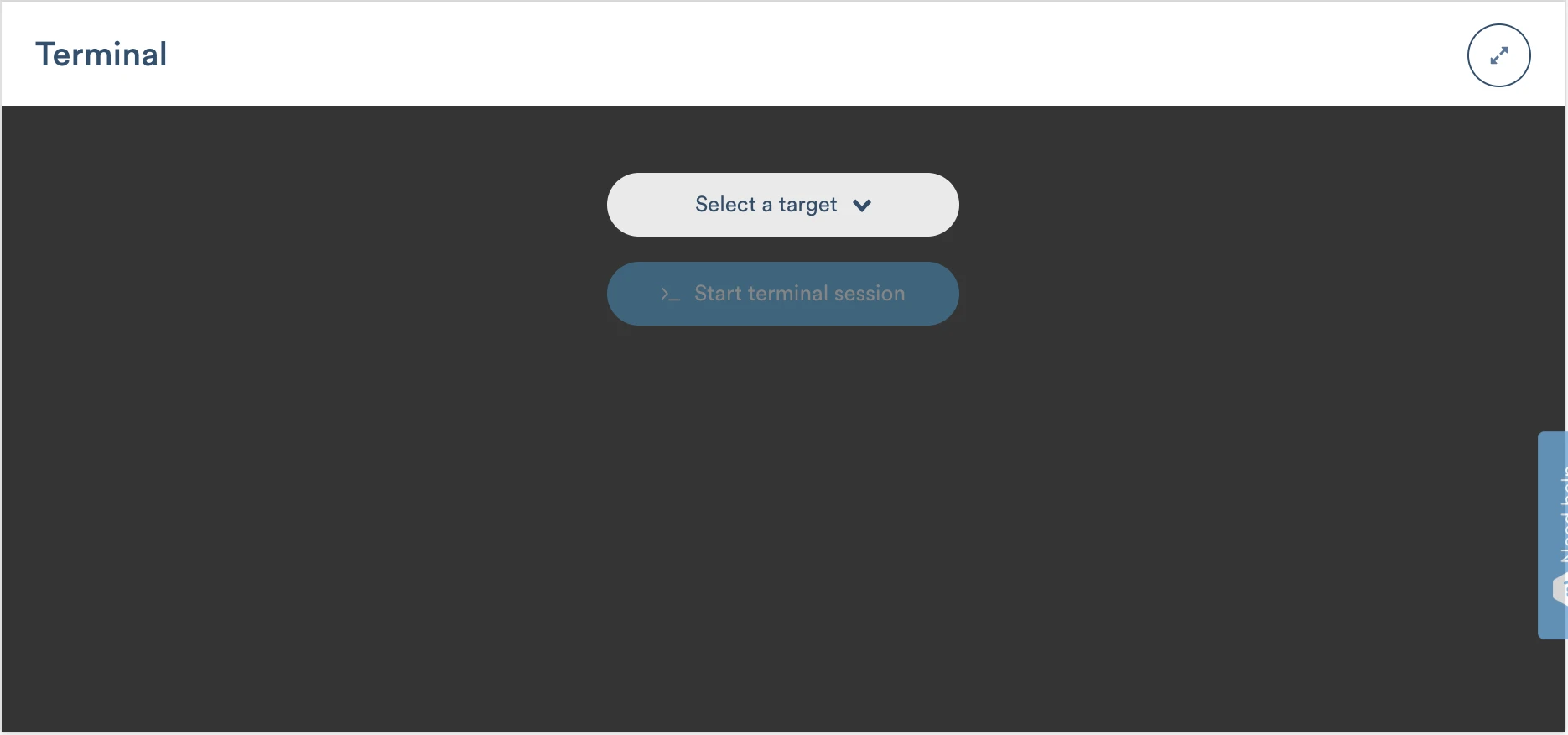

To use this feature, navigate to your fleet and select the device you want to access. You will see a *Terminal* window below the *Logs* window:
<figure><img src="https://3346268949-files.gitbook.io/~/files/v0/b/gitbook-x-prod.appspot.com/o/spaces%2F8MXngJ2SifhuKl2pgGbI%2Fuploads%2Fgit-blob-56ca846e4d01de12e42fbae05c9a1f9bbaed96f4%2Fterminal.webp?alt=media" alt=""><figcaption></figcaption></figure>
If your device is online, select a target as either the host OS or a running service, and click the blue *>\_ Start Terminal session* button. In order to start a terminal session for a service, you need to ensure that the service container is running. If the container code crashes or ends quickly, it is not possible to attach a console to it.
A terminal session should be initiated for you in a second or two. If you would like a bigger window for the terminal, you can click the *Expand* button in the upper-right corner.
To copy and paste in the terminal window, you cannot use the normal Ctrl + C and Ctrl + V shortcuts. You can either select Copy and Paste from a menu, or use Ctrl + Insert for copy and Shift + Insert for Paste. For MacOS users, ⌘ + C and ⌘ + V work as expected.

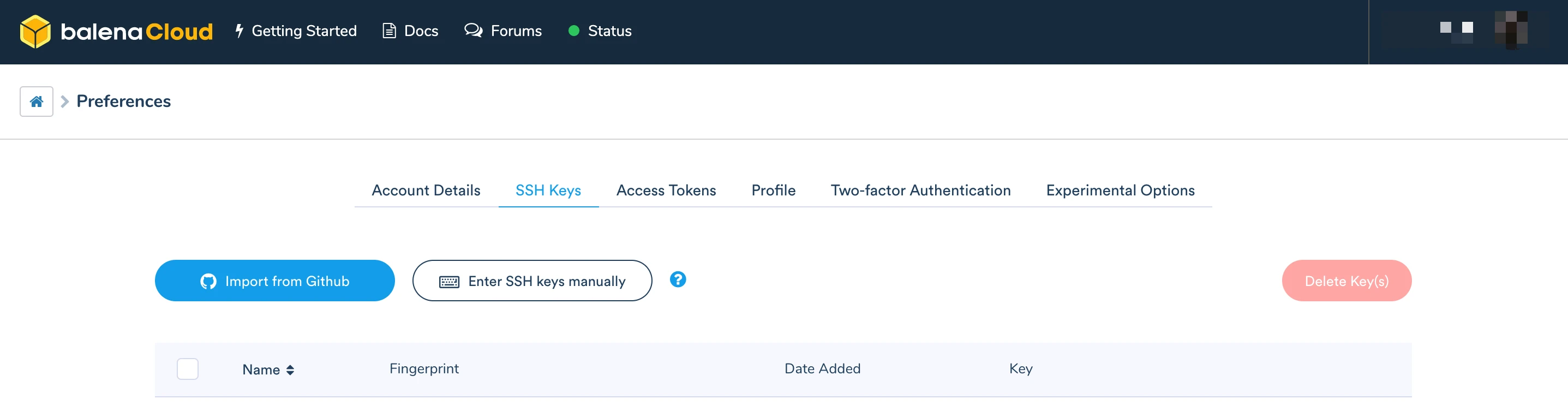

### Add an SSH key to balenaCloud
To add an SSH key, go to the *Preferences* page of balenaCloud and select the *SSH Keys* tab.
<figure><img src="https://3346268949-files.gitbook.io/~/files/v0/b/gitbook-x-prod.appspot.com/o/spaces%2F8MXngJ2SifhuKl2pgGbI%2Fuploads%2Fgit-blob-6f26ea59498a7cf4798a0dda62f0d1221cb7b1b2%2Fpreferences-ssh-keys.webp?alt=media" alt=""><figcaption></figcaption></figure>
You may either import an existing SSH key from GitHub or manually enter the public SSH key of an existing SSH key on your development machine.
If you do not have an existing key, you can follow [GitHub's documentation](https://help.github.com/en/github/authenticating-to-github/generating-a-new-ssh-key-and-adding-it-to-the-ssh-agent), skipping the step about adding the key to your GitHub account, and instead adding the key to your balenaCloud account.
