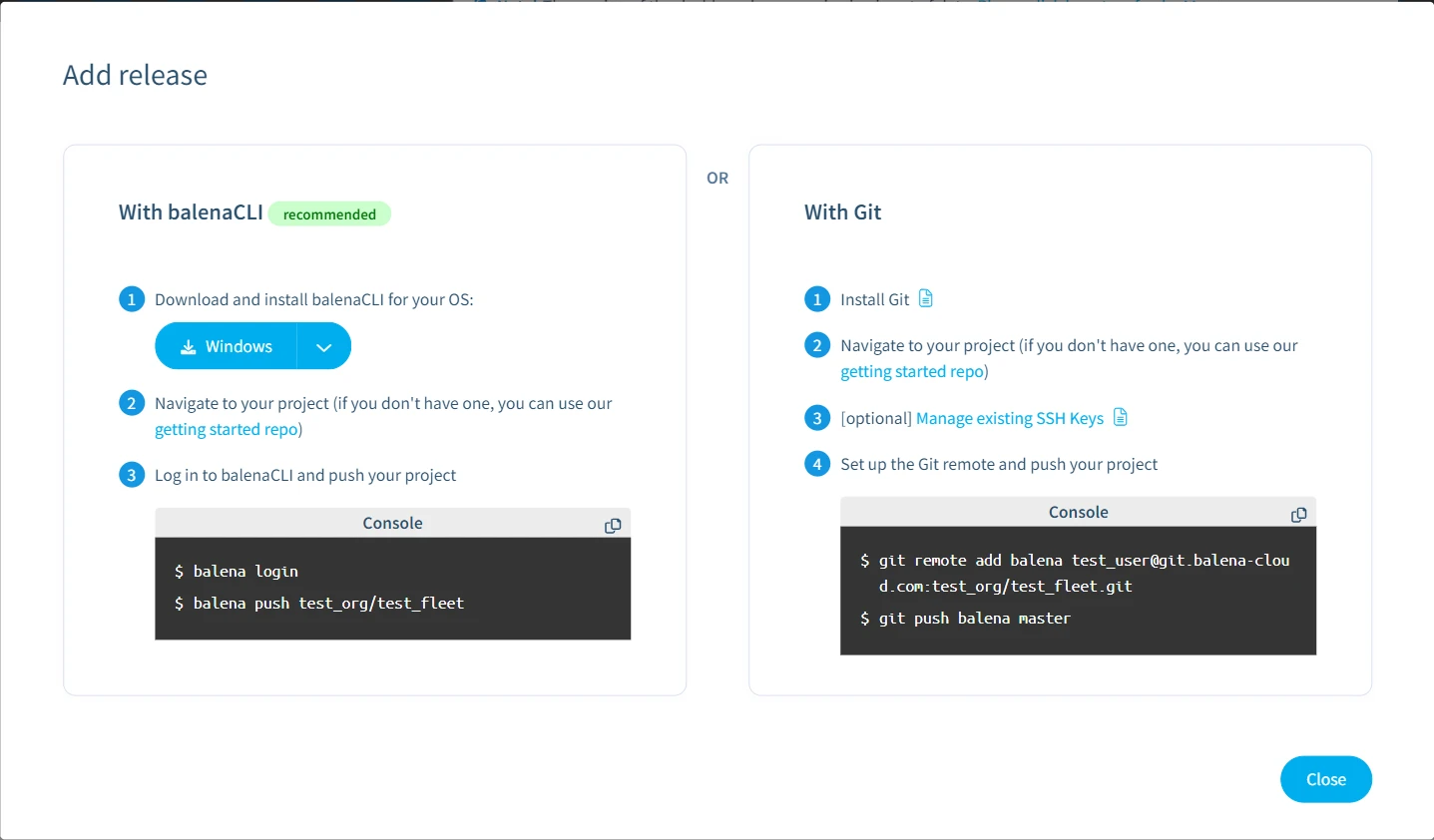

There are 3 ways to create and deploy a release, namely balena push, balena deploy and git push. Each method has slightly different use cases and differ on how and where the container images are built. We'll explain each of the options in more detail below. If you are just starting out with balenaCloud, we recommend using balena push.

balena push is the recommended method for deployment and development on the balenaCloud platform. To use balena pushyou need to first install the balena CLI and ensure you are logged in to your account withbalena login.

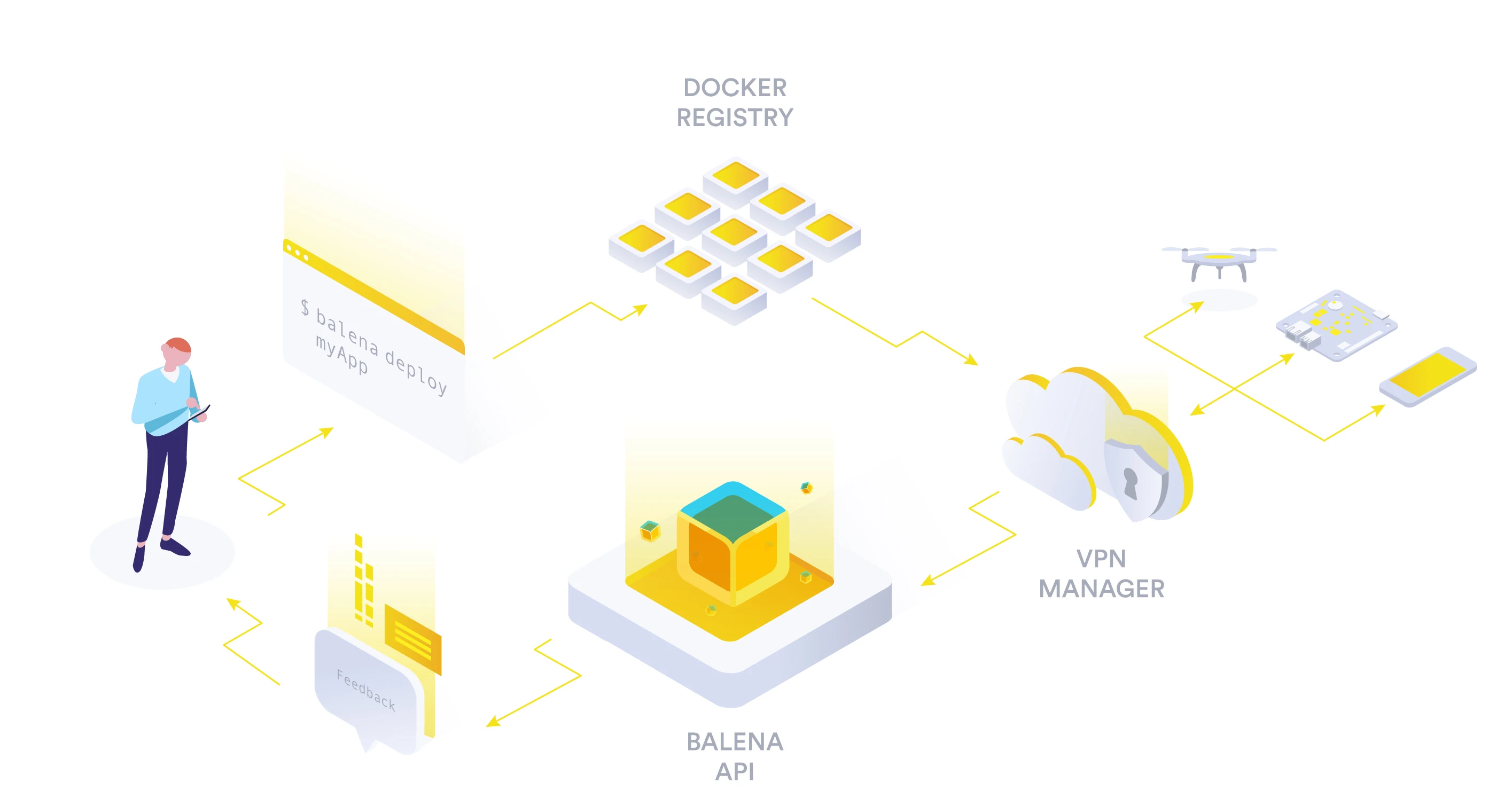

When you run the balena push <APP_NAME or DEVICE_IP> command from your laptop it will essentially take your project (or repository) folder, compress it and send it to the balenaCloud build server or local balenaOS device in localMode where it will be built.
Once the cloud builder has successfully completed building all the images in the deployment, it will upload these images to the balenaCloud registry and create a release entry in the balena API database. It will then notify all the devices in the fleet that a new release is available. If you need to pull in proprietary code or use a private base image during your builds, you can do so using the build time secrets or private base images feature of balena push.

The balena deploy is functionally very similar to balena push but avoids pushing any source code to the balenaCloud build server. It gives more control over how and where your container images are built, allowing for balena deploy to be integrated into your own CI/CD build system.
With balena build container images are built on your development machine or on a remote machine, by specifying a docker daemon's IP address and port number with the relevant command-line options (for example a device running a balenaOS development image). Depending on your fleet's targeted CPU architecture builds will be run emulated via qemu.
If you are building your own container images, balena deploy will upload the images to the balenaCloud image registry and then create a release entry in the balena API database. The devices in the fleet will then be notified of a new release and download it. Should balena deploy not find the required images on the specified docker daemon, it will automatically trigger a build.

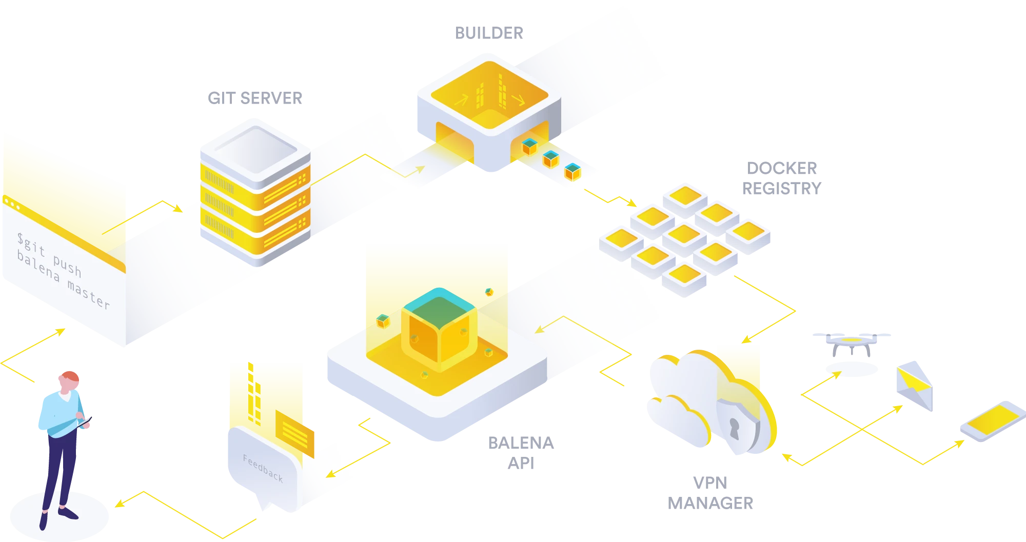

The git push balena master method of deployment is the original deployment mechanism for balenaCloud. While we continue to support git push, it is considered a legacy method for pushing code to a fleet, and if possible you should use balena push as it makes for a consistent workflow and methodology.
The git push workflow requires that you have git installed on your development machine and that you have an SSH key setup on your balenaCloud account.
Then, simply add your balenaCloud app's git endpoint to your local git repository via git remote add balena <fleet git endpoint> . You can find the fleet git remote endpoint by clicking the 'Add release' button in the releases tab of the dashboard.
Whenever you subsequently need to push code to your devices, simply run git push balena master.

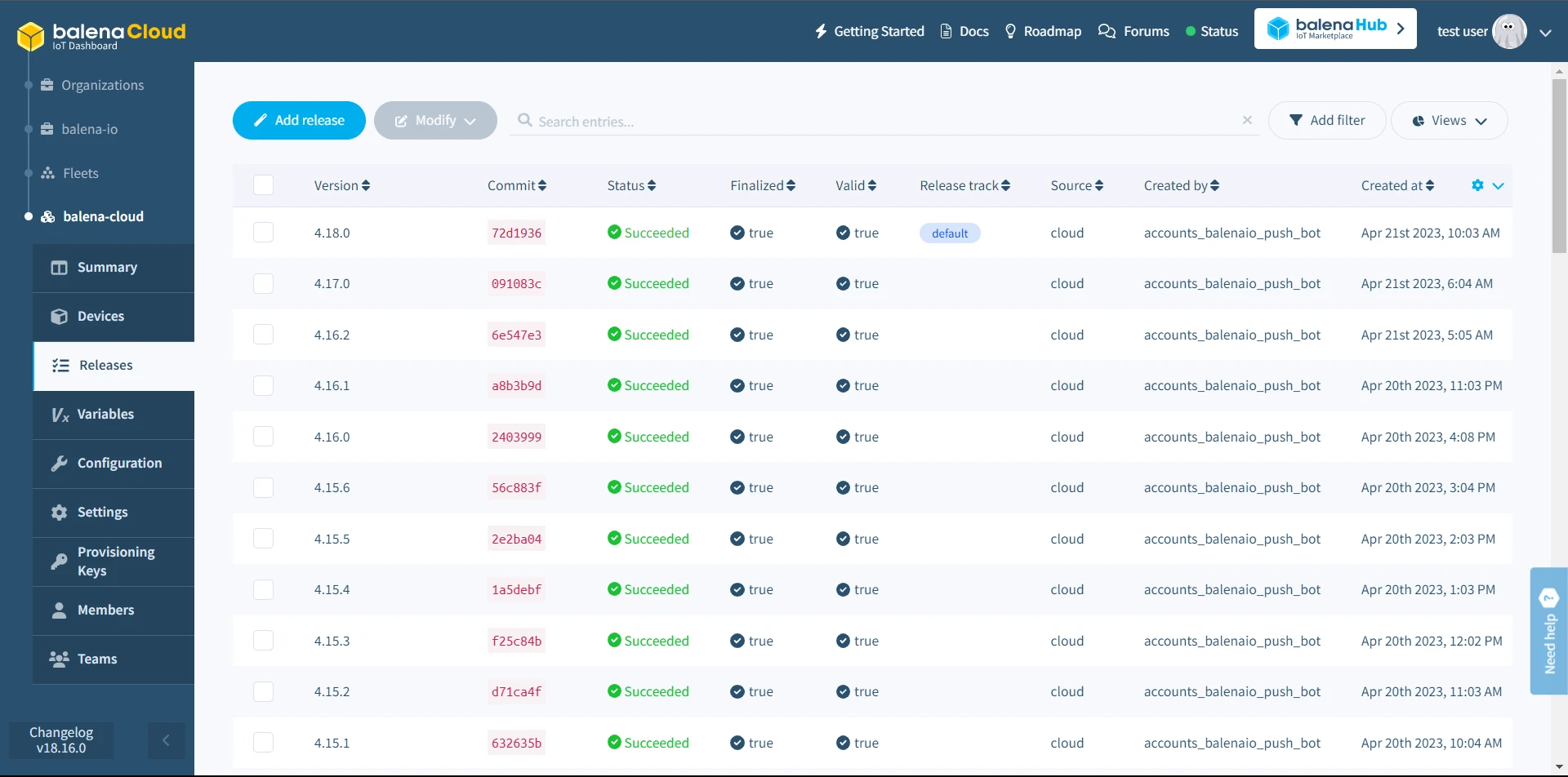

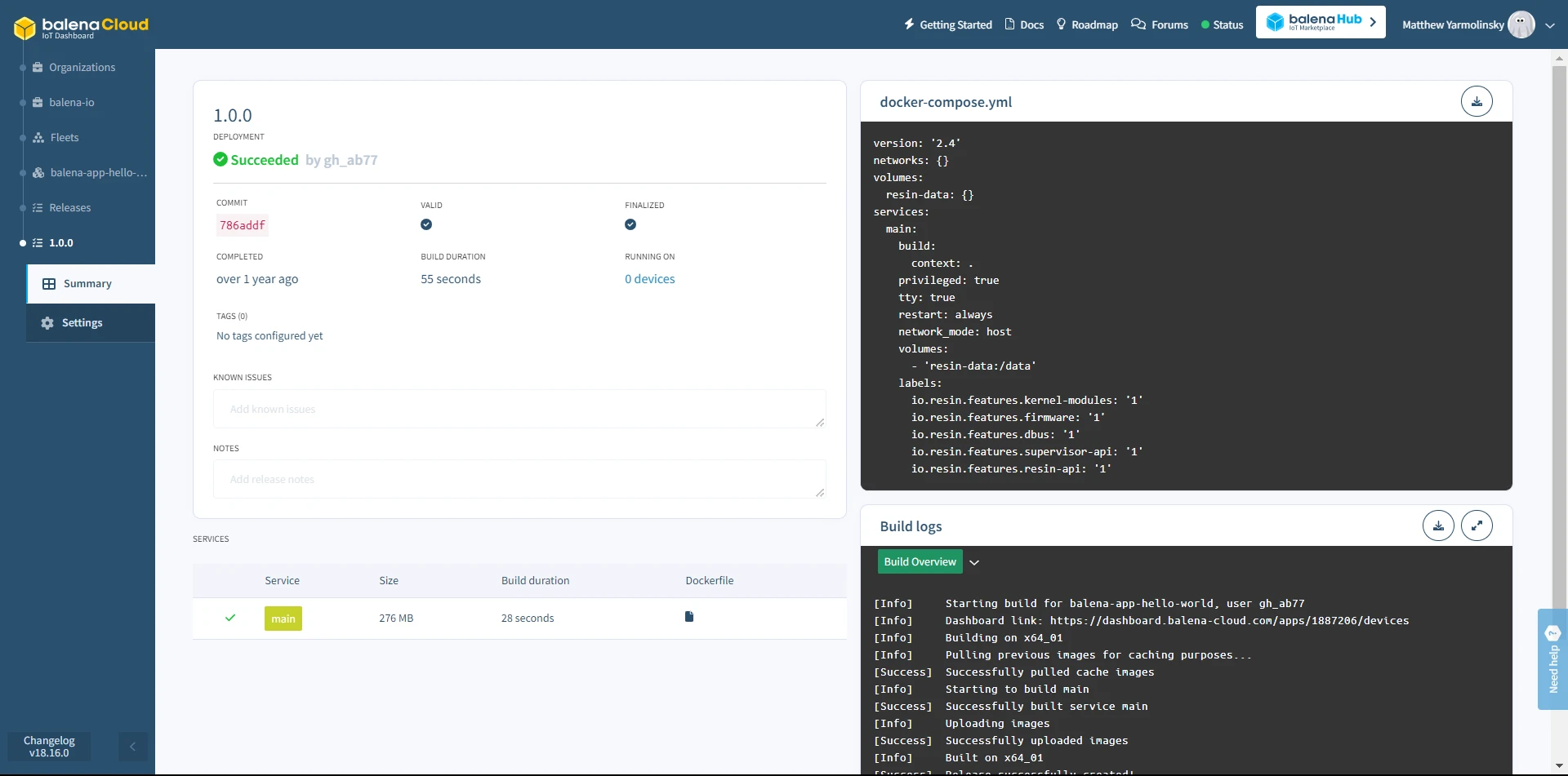

View Past Deployments
All successful deployments will result in a release being added to balenaCloud. These releases are tracked in their own dashboard page accessed via the fleet:
The releases page includes a list of all attempted and deployed releases, with information on the status of the release, when it was completed, how long it took, and how many devices are on that particular release. Clicking any row will open up a summary page specifically for that release, with windows showing the docker-compose.yml file and Build Logs:
Much like with the device list, filters can be added to the release list by clicking Add filter and filling in the appropriate fields:
Saved views can also be created to return to a specific collection of filters.
