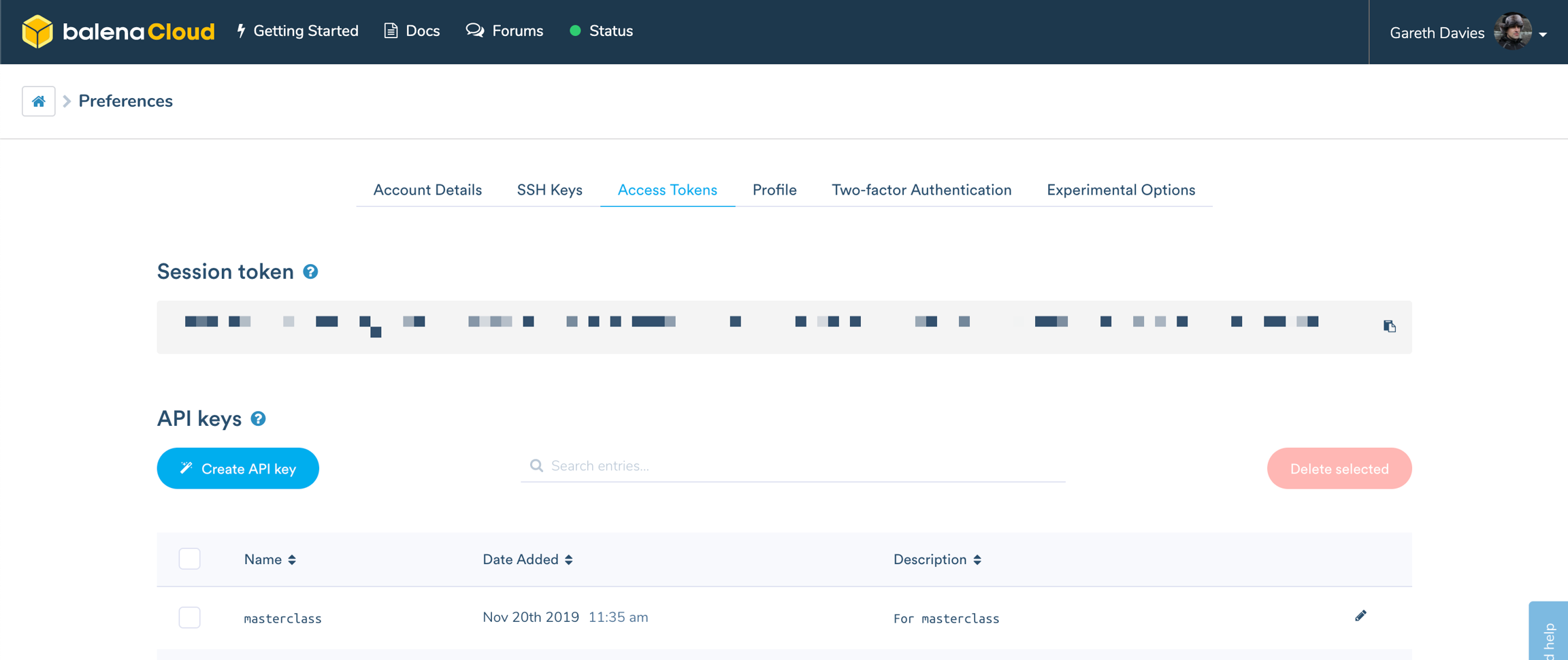

### 2. Access Tokens
During the masterclass, we will use the [balena API](https://www.balena.io/docs/reference/api/overview/) to manage the fleet and device(s). To get started using the API, you need an access token. Access tokens are managed via the *Access tokens tab* of the [*Preferences* page](https://dashboard.balena-cloud.com/preferences/access-tokens) of the dashboard.
![Access tokens](https://github.com/balena-io-projects/balena-fleet-management-masterclass/raw/master/resources/rmGIGgB.png)
Access tokens may be used to authenticate via the CLI, [SDKs](https://github.com/balena-io/balena-sdk), and all API endpoints. Access tokens should be treated as sensitive and stored securely and never committed to a version control system. Balena offers two types of access tokens that offer the same user-level permissions to manage fleets, devices, and the associated user account.
* **Session tokens** - these tokens expire after seven days and cannot be revoked, though they may be refreshed via the API.
* **API Keys** - these are named tokens that do not expire and may be revoked as needed.
Either type of access token can be used for this masterclass. Session tokens are much longer and may cause an issue in specific environments when executing shell commands using them, so using an API key for this masterclass is preferable. Once created, save the API key to an variable for the current shell with the following command, replacing `<YOUR_API_TOKEN>` with the value of the token obtained from the dashboard.

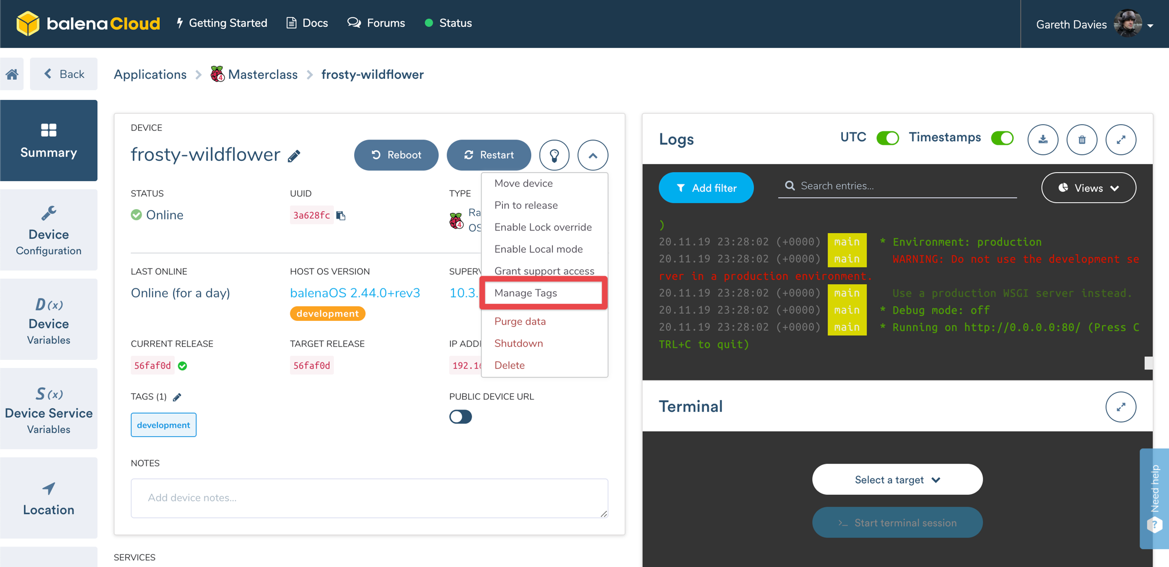

#### 4.1 Add a Device Tag using the Dashboard
Add a tag from the Fleet dashboard by clicking the checkbox to the left of the device(s) you wish to tag, followed by the *Tags* button on the right side of the dashboard.
Enter the name of the tag as `devDevice` to identify this device as a development one in the fleet for our use (we will later use this tag in the examples for filtering). We can specify a name only or both a name and value pair. In this example, we are just adding a tag name. Tag names must be unique.
> Note, the following GIFs and screenshots use the tag `development`. However, to avoid confusion with the host OS version (also named development) it is strongly recommended you create your tag as `devDevice` or similar.
![Adding a tag via the dashboard](https://github.com/balena-io-projects/balena-fleet-management-masterclass/raw/master/resources/ltzofvx.gif)
To edit the tag, you can repeat the process, selecting the device(s) and clicking the *Tags* button where you can edit any existing tags. You can also manage tags from the device summary page.
![Device Summary](https://github.com/balena-io-projects/balena-fleet-management-masterclass/raw/master/resources/exXJPh8.png)

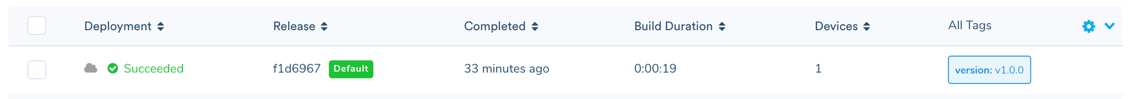

We can confirm that this worked by visiting the Fleet dashboard and clicking the *Releases* tab. You may need to add a new column to view the tags associated with the releases and our newly created `version:v1.0.0` tag.
![Release tag](https://github.com/balena-io-projects/balena-fleet-management-masterclass/raw/master/resources/1vrS6bw.png)
> You can edit a tag via the API by issuing a PATCH request to `https://api.balena-cloud.com/v5/release_tag(1156095)` again using the release ID. To delete the tag, send a DELETE request to the same URL. For more information, consult the [API documentation](https://www.balena.io/docs/reference/api/overview/).

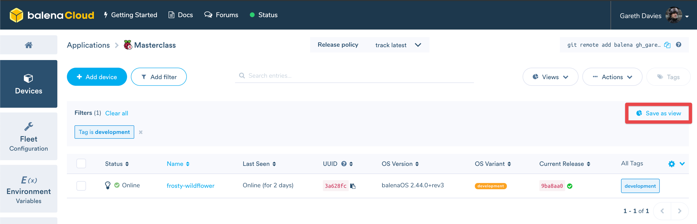

#### 5.2 Create a View
Views allow us to save filters, rather than having to reenter them each time we want to filter our devices. For example, we will save the current filter, which selects all devices with a tag name of `devDevice` to a view named *Development Devices*. Create this view by selecting the *Save as view* link, which is visible whenever there is a filter applied.
![Save a view](https://github.com/balena-io-projects/balena-fleet-management-masterclass/raw/master/resources/1Yodp3X.png)

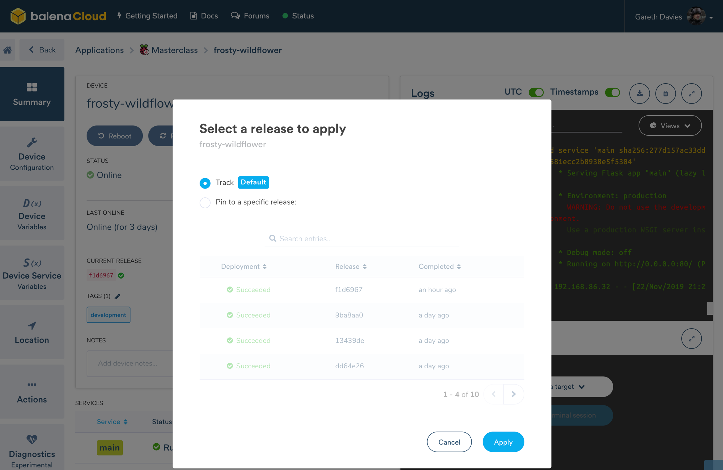

#### 6.1 Pin a Fleet to a Release
In the last exercise, we pushed a release that we tagged as `version:v1.0.0`. We want our fleet to remain on this release even if newer releases are deployed (for example, we may wish to test the newer releases on a subset of devices before we push to the remainder of the fleet).
In the Fleet dashboard, there is a *Release policy* header. By default, this is set to `track latest`, which means that new releases are immediately deployed to all devices in the fleet when built. Expanding this *Release policy* dropdown menu displays all releases for the fleet, from which you can select a specific release to pin the fleet to. When the fleet is pinned, all devices are immediately updated to run the pinned release if they are not already running it, and in the future, releases will not be deployed until the *Release policy* is updated to a newer release or set to `track latest`.
Pin your fleet to the latest release by selecting it from the dropdown.
![Pin fleet to release](https://github.com/balena-io-projects/balena-fleet-management-masterclass/raw/master/resources/OdrQvC7.gif)

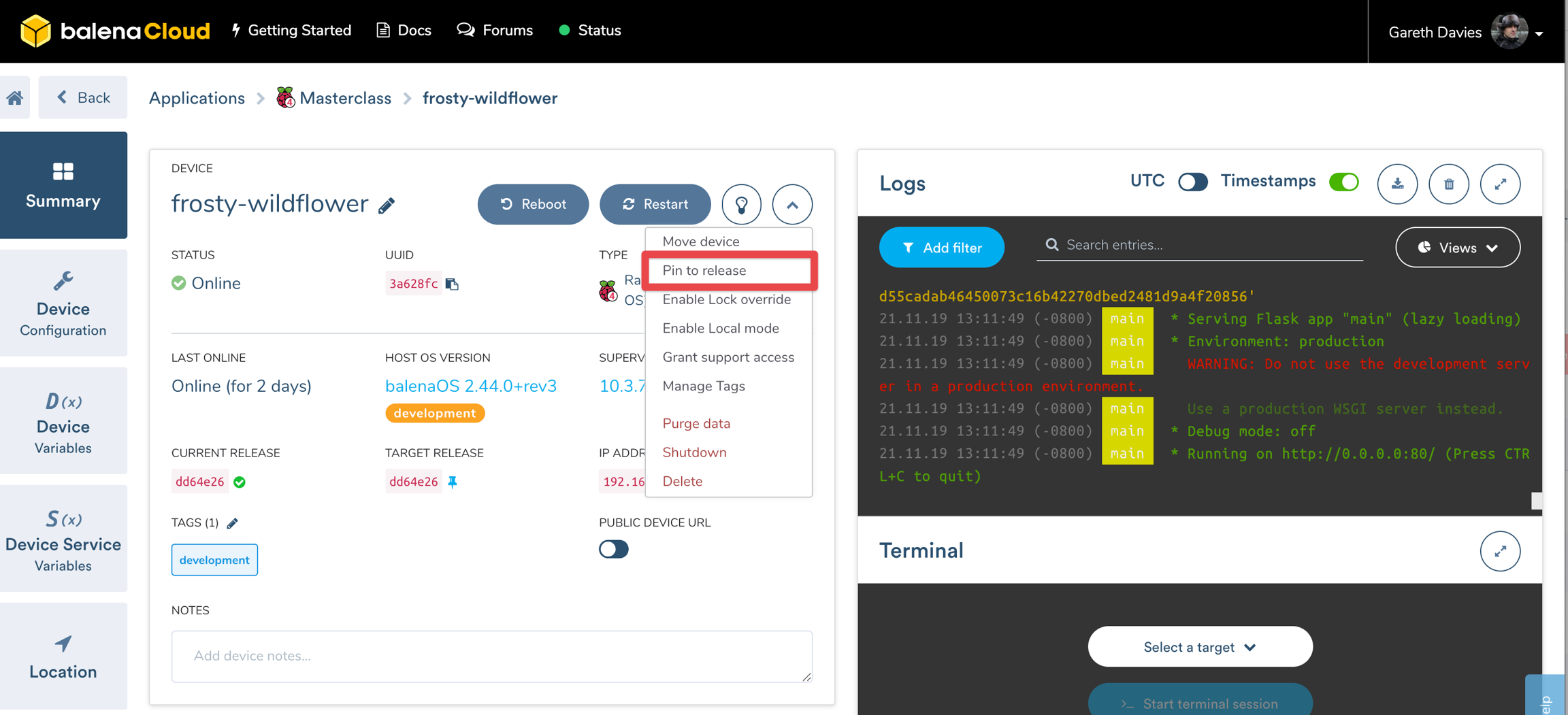

#### 6.2 Pin Device to a Release

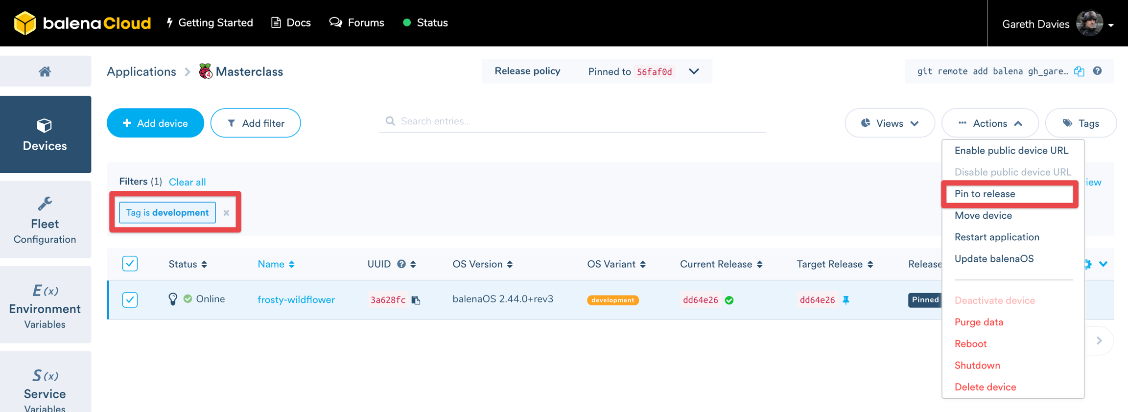

As well as pinning an entire fleet to a specific release, you may pin individual devices. By default, all devices track the fleet release policy. However, you may wish to run a different release on select devices, for example, a development device or when performing a canary deployment where a subset of devices receive the update to evaluate it before pushing more widely.
From the fleet dashboard, select the device(s) you wish to pin and choose *Pin to release* from the Actions menu and select the latest release.
![Pin device to release](https://github.com/balena-io-projects/balena-fleet-management-masterclass/raw/master/resources/oIyfmmc.gif)
You may also pin a device from the device dashboard:
![Pin device via dashboard](https://github.com/balena-io-projects/balena-fleet-management-masterclass/raw/master/resources/DiG8bvQ.png)
The pinned device will update immediately to run the latest release (if it is not already). Once the device has updated, again validate it is running the latest release with the command:
```bash
curl 3a628fc.local
I am version 2.0.0 of the Masterclass

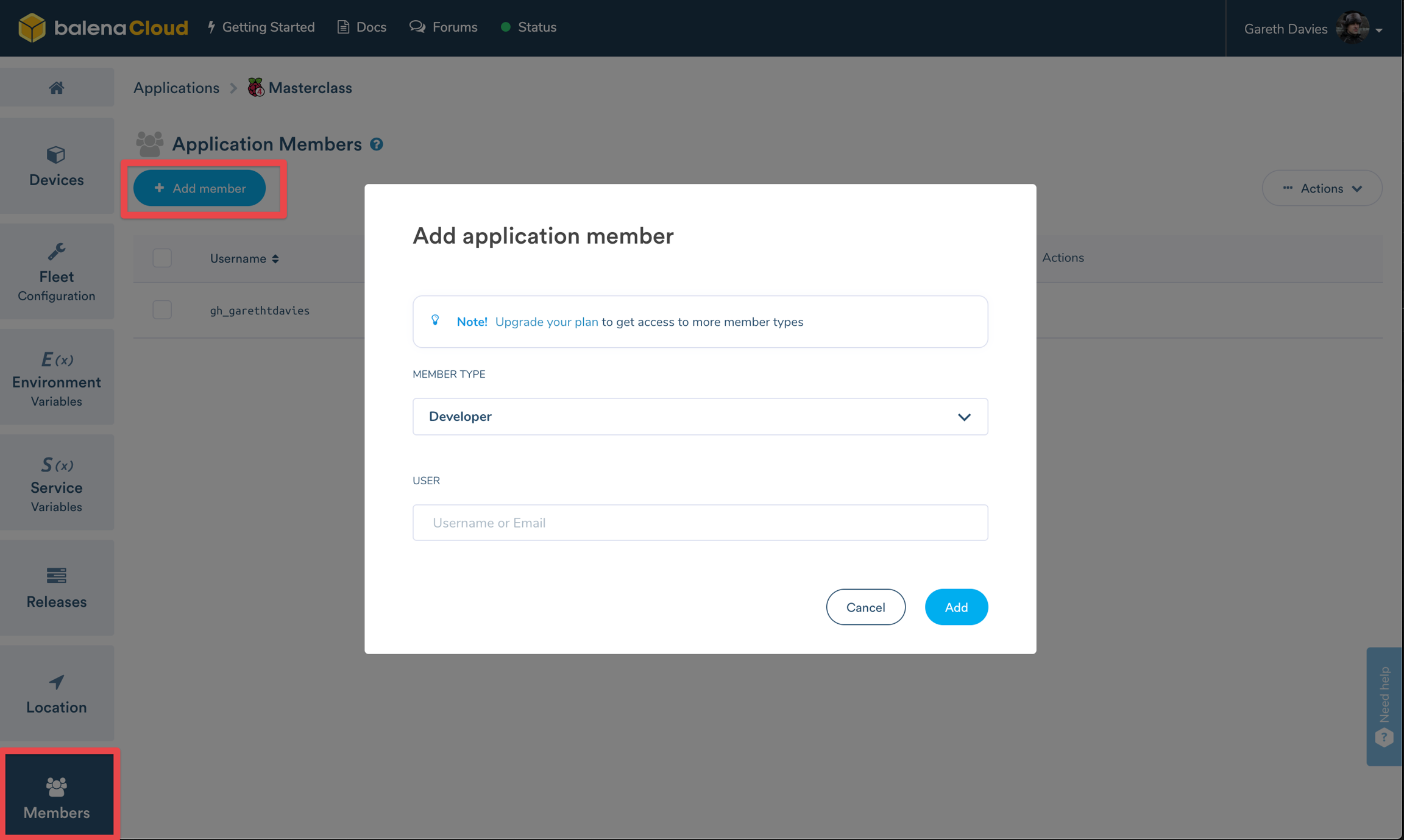

In balenaCloud, there are multiple member types, each offering different permissions (some of which are only available to paid plans). You can add members to the fleet on the *Members* tab of the dashboard:
![Add fleet member](https://github.com/balena-io-projects/balena-fleet-management-masterclass/raw/master/resources/cNNoT1K.png)
* **Owner** - The user who created the fleet and has full permissions to add other members and remove the fleet.
* **Observer** - Observers are given read-only access to the fleet and its devices.
* **Operator** - Operators have all the access given to observers, plus the ability to manage fleet devices. This means operators can remove devices, perform device actions, and modify device tags, metadata, and variables. Operators also have full SSH access to the fleet devices.
* **Developer** - Developers are given, in addition to the access provided to operators, the ability to manage a fleet. This includes pushing new code, modifying fleet-wide variables, running fleet actions, and downloading fleet images.

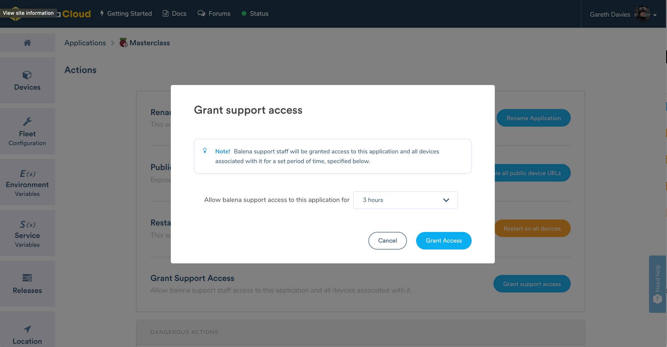

### 9. Enabling Support
It is possible to enable support access to the entire fleet or to individual devices for a set time period.
To enable support access for a single device, select the *Actions* menu in the Device dashboard, and choose the *Grant Support Access* button and choose the period of time to grant device access. You may revoke access at any time by selecting *Revoke Support Access* on the same page.
![Enable support for a device](https://github.com/balena-io-projects/balena-fleet-management-masterclass/raw/master/resources/L1EjGQa.gif)
To enable support access for an entire fleet, select the *Grant Support Access* from the *Actions* menu of the Fleet dashboard and choose the period of time to grant access to all devices in the fleet. Again, this may be revoked at any time by selecting *Revoke Support Access* on the same page.
![Enable support access for a fleet](https://github.com/balena-io-projects/balena-fleet-management-masterclass/raw/master/resources/2eMvJf8.png)
