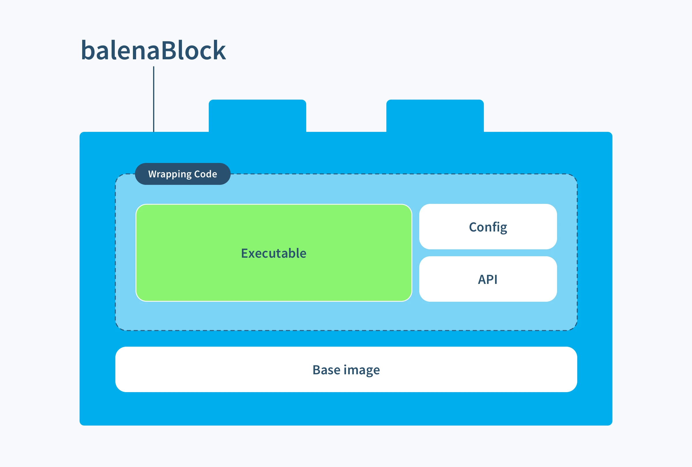

A block is a container image that can be added to a multicontainer fleet in order to provide specific functionality. Blocks are intended to reduce the friction of app development by making it easier to re-use functionality, much like software packages.
Similar to how software developers don't want to keep rewriting common functions, IOT developers don't want to keep creating containers for common tasks, such as handling Bluetooth connections or interacting with attached displays. Blocks provide solutions to common IoT application requirements, which developers can re-use to enable their fleet.
For example, getting a browser to run well in a container is a tedious task. Hence, why not use the [browser block](https://github.com/balenablocks/browser) to get things up and running faster..

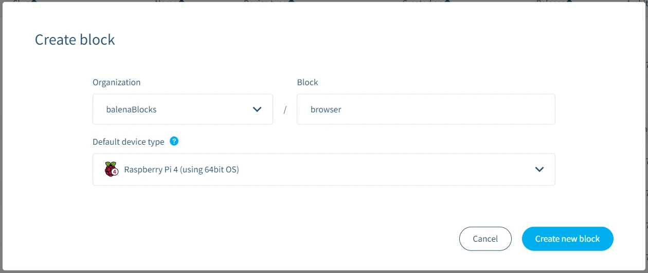

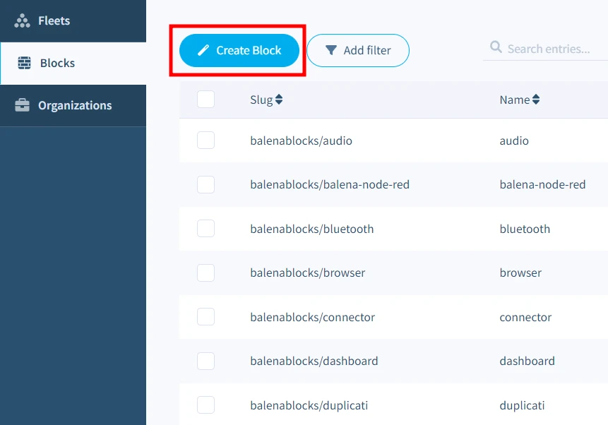

Next, navigate to the `Blocks` tab in the sidebar and click the `Create block` button in the balenaCloud dashboard.
<figure><img src="https://3346268949-files.gitbook.io/~/files/v0/b/gitbook-x-prod.appspot.com/o/spaces%2F8MXngJ2SifhuKl2pgGbI%2Fuploads%2Fgit-blob-1c43acdbd4751ef193d06b612a3406196a873baa%2Fimage.webp?alt=media" alt=""><figcaption></figcaption></figure>
Fill the details for your block in the modal, and click `Create new block` button to create your block.

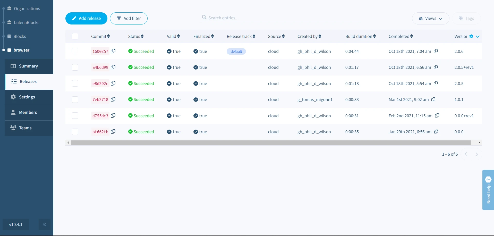

To deploy new releases of your block, you can use the [balena-push](https://docs.balena.io/learn/deploy/deployment.md#balena-push) command using the [balenaCLI](https://github.com/balena-io/balena-cli). The `Releases` tab in the sidebar will show the list of all releases of your block.

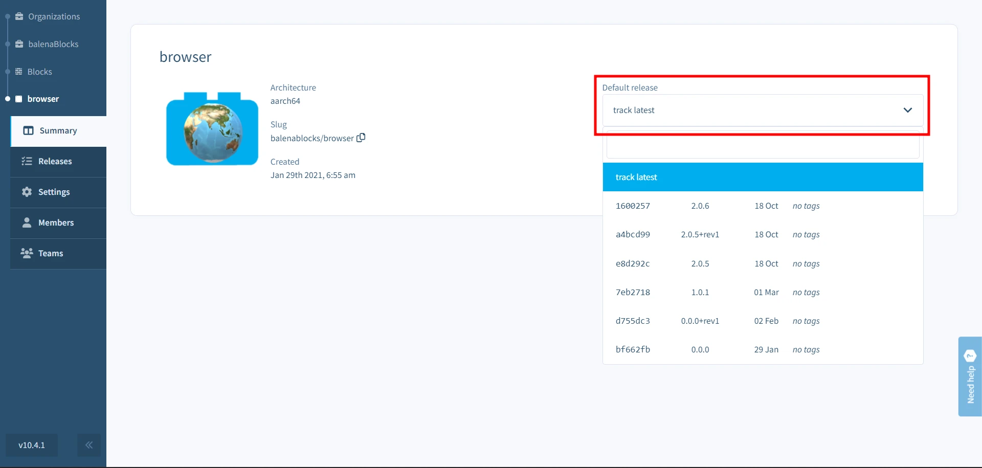

By default, the block is set to `track latest`, which means that new releases are immediately tagged as the default release for the block. Expanding this *Default release* dropdown menu displays all successful releases for the block, and you can select a specific release to pin the block to. When a particular release is selected, that release will be tagged as the default release of your block. After pinning to a specific release, releases will not be deployed until the *Default release* is updated to a newer release or it's set back to `track latest`.

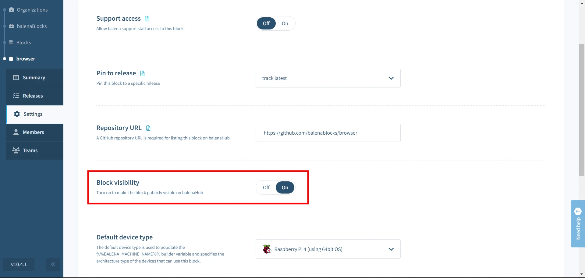

When blocks are private, you can iterate, test and build more functionality before making it available to the world. When you are ready to release, head to the `Settings` tab in the sidebar and add your block's GitHub repository to the `Repository URL` section. Next, toggle the `Block visibility` button to `on` for your block to be visible on balenaHub. You’re free to toggle the visibility on and off as necessary at any time.

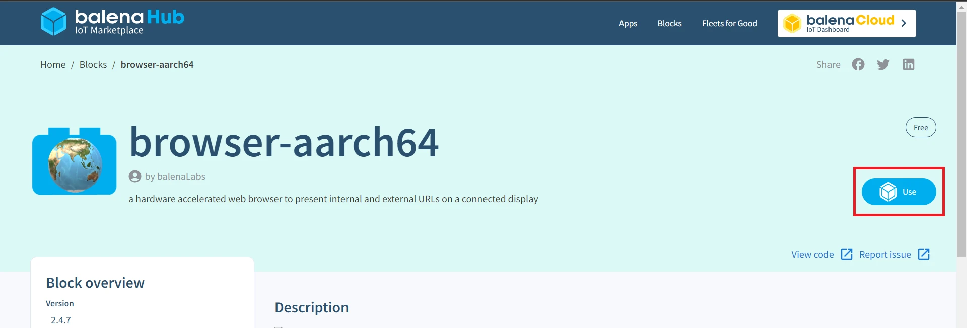

The URL to pull your block image (the *image reference*) is available in balenaHub by clicking the `Use` button.
<figure><img src="https://3346268949-files.gitbook.io/~/files/v0/b/gitbook-x-prod.appspot.com/o/spaces%2F8MXngJ2SifhuKl2pgGbI%2Fuploads%2Fgit-blob-bd7e2f3c9e2ca64e6497d08d74d3e397f78242db%2Fuse-button.webp?alt=media" alt=""><figcaption></figcaption></figure>
This image reference can be used in a Dockerfile or docker-compose file to pull the *default release* image of your block.
