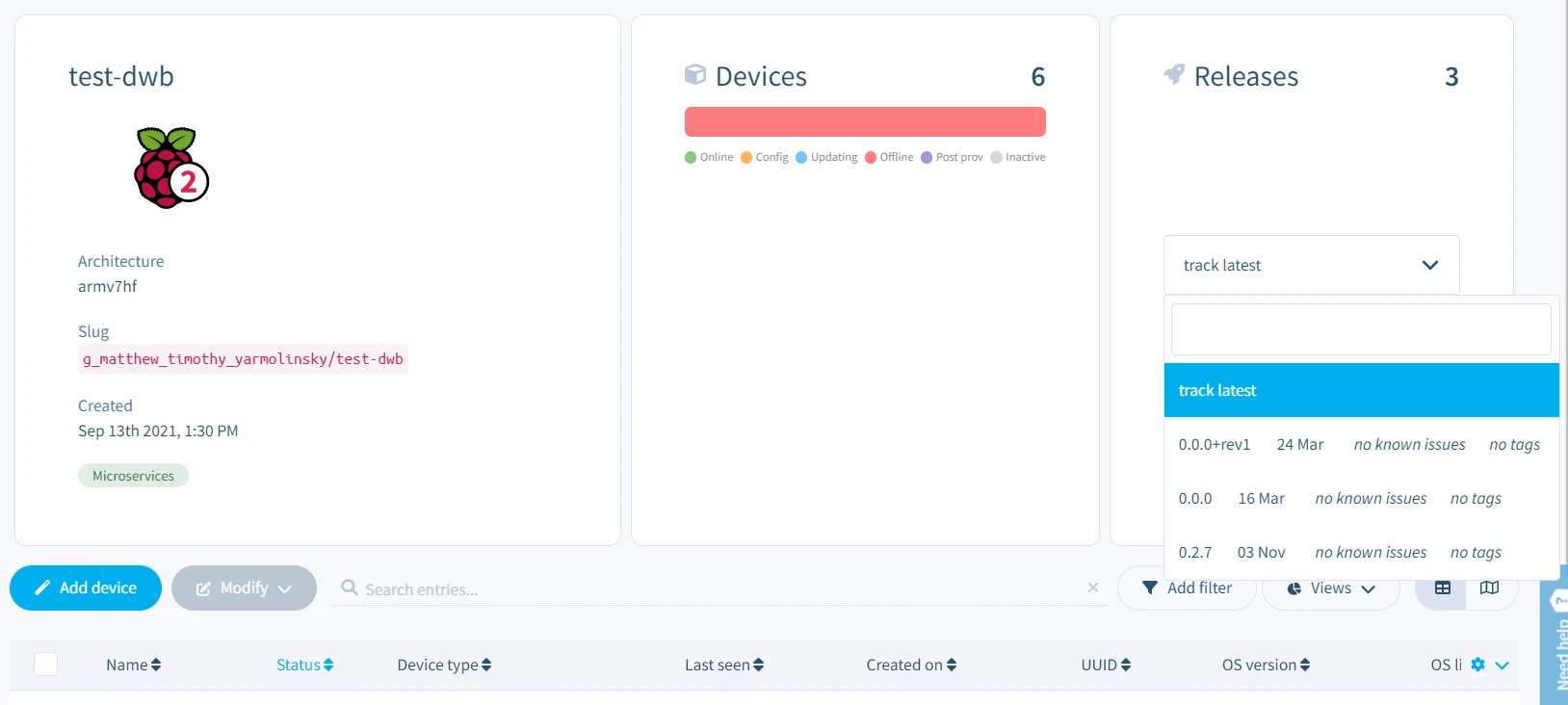

You can set the release the fleet is pinned to via the Releases card on the on the Fleet Summary page.

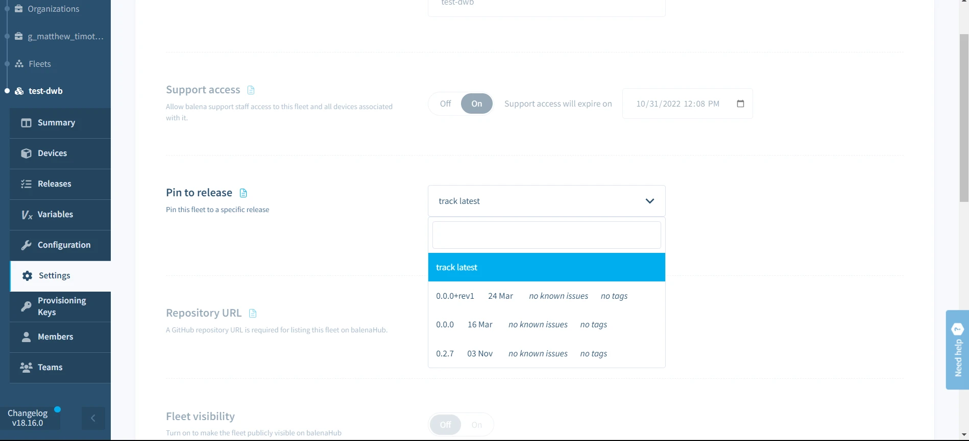

This can also be achieved using the `Pin to release` setting on the Fleet settings page.
<figure><img src="https://3346268949-files.gitbook.io/~/files/v0/b/gitbook-x-prod.appspot.com/o/spaces%2F8MXngJ2SifhuKl2pgGbI%2Fuploads%2Fgit-blob-61e81913ee980070543bfd5fe60d3cb0c8a9f12e%2Fpin_to_release_setting.webp?alt=media" alt=""><figcaption></figcaption></figure>
The dropdown menu at each of the above locations displays all successful and valid releases for the fleet.

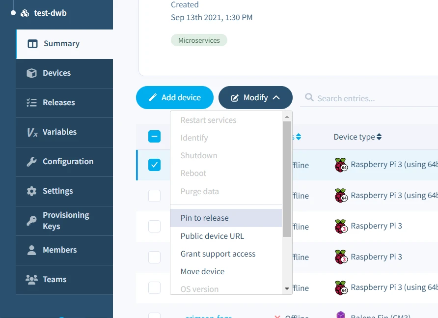

* On the Devices page, you can select one or more devices using the checkboxes present on the table. Next, open the `Modify` menu and select the `Pin to release` option.

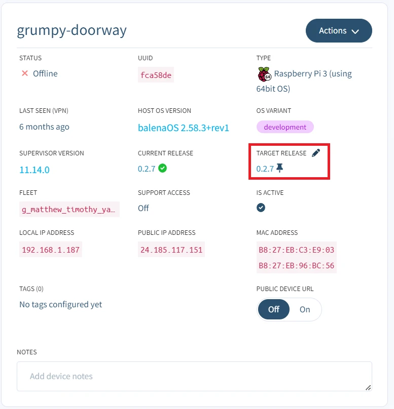

* Alternatively, on hovering over the `Target release` property in the Device summary page, you will see a pencil icon appear. This can be used to pin the release as well.

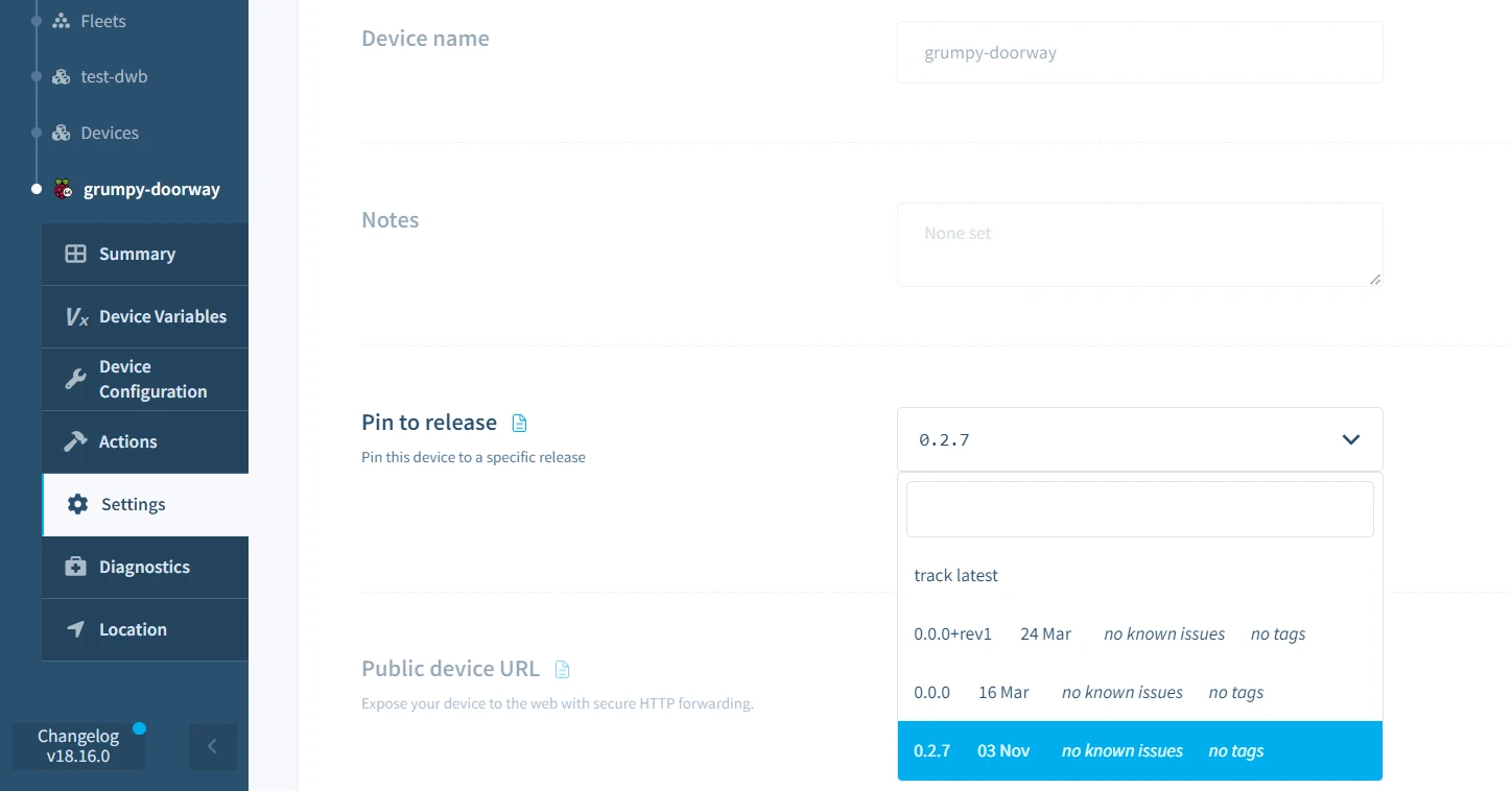

* Lastly, the Settings page of a device also has the option to pin the release.

Once the device has been pinned to a release and updated, its `Target release` column updates to the pinned release. It will show a pin, rather than just showing the release targetted by the fleet. The `Release policy` column also updates to say `Pinned`.
<figure><img src="https://3346268949-files.gitbook.io/~/files/v0/b/gitbook-x-prod.appspot.com/o/spaces%2F8MXngJ2SifhuKl2pgGbI%2Fuploads%2Fgit-blob-e03ffa452640bfd29e41edf6afbba5fa33162535%2Ftarget_release_pin.webp?alt=media" alt=""><figcaption></figcaption></figure>
