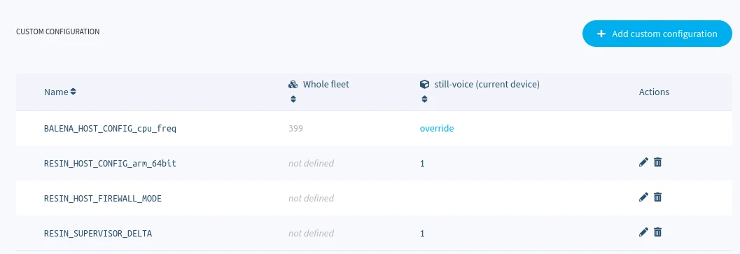

## Adding custom configuration
The custom configuration section can be used to modify configuration options beyond the ones pre-populated for your device using the balenaCloud dashboard. Examples include, [modifying config.txt using configuration variables](https://docs.balena.io/pages/Rd7YL6C3zhNiyGIxCsXW#modifying-config.txt-using-configuration-variables) for Raspberry Pi devices.
To define custom fleet wide configuration, scroll past the automatically populated options, then click the *Add custom configuration* button in the lower-right corner:
<figure><img src="https://3346268949-files.gitbook.io/~/files/v0/b/gitbook-x-prod.appspot.com/o/spaces%2F8MXngJ2SifhuKl2pgGbI%2Fuploads%2Fgit-blob-58ef571f16f5e6e684229b47b87f10e15a7f1c07%2Fadd_fleet_configuration.webp?alt=media" alt=""><figcaption></figcaption></figure>
A dialog pops up giving you the option to define a name and value (remember, all config variable names must begin with `BALENA_` or `RESIN_`). Click *Add* to apply:
<figure><img src="https://3346268949-files.gitbook.io/~/files/v0/b/gitbook-x-prod.appspot.com/o/spaces%2F8MXngJ2SifhuKl2pgGbI%2Fuploads%2Fgit-blob-55157ba37dda93b63427004dd93a273203ee31ef%2Fvariable_editor_config.webp?alt=media" alt=""><figcaption></figcaption></figure>
Adding custom device configuration is similar to adding custom fleet configuration. You can override the value of custom fleet configuration by clicking *override* inside device configuration. This will pop up the variable editing dialog, where you can change the value:
<figure><img src="https://3346268949-files.gitbook.io/~/files/v0/b/gitbook-x-prod.appspot.com/o/spaces%2F8MXngJ2SifhuKl2pgGbI%2Fuploads%2Fgit-blob-3c569ae798ff6a2641e4230fd36e625f342e9662%2Fadd_device_custom_variable.webp?alt=media" alt=""><figcaption></figcaption></figure>
