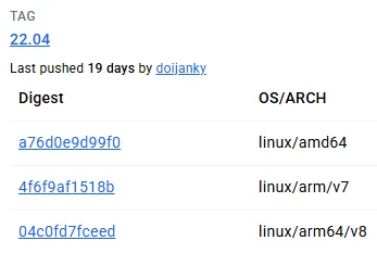

For instance, we can see the digests listed for ubuntu 22.04 in Dockerhub:
<figure><img src="https://3346268949-files.gitbook.io/~/files/v0/b/gitbook-x-prod.appspot.com/o/spaces%2F8MXngJ2SifhuKl2pgGbI%2Fuploads%2Fgit-blob-c7791b95ef14892d1694dd35dc69258c96cd69e1%2Fdigests.webp?alt=media" alt=""><figcaption></figcaption></figure>
Clicking on the one for linux/arm64/v8, we can copy the full digest by clicking the link:
<figure><img src="https://3346268949-files.gitbook.io/~/files/v0/b/gitbook-x-prod.appspot.com/o/spaces%2F8MXngJ2SifhuKl2pgGbI%2Fuploads%2Fgit-blob-44af0199f7f9a8e9162c8c3a198eb3f1c80415b3%2Fdigest_link.webp?alt=media" alt=""><figcaption></figcaption></figure>
And then we can use that digest instead of the tag to always get the same version of Ubuntu 22.04:
FROM ubuntu@sha256:04c0fd7fceedf5c0fe69ec1685c37cf270f03ae424322a58548b095528f4a3c3
