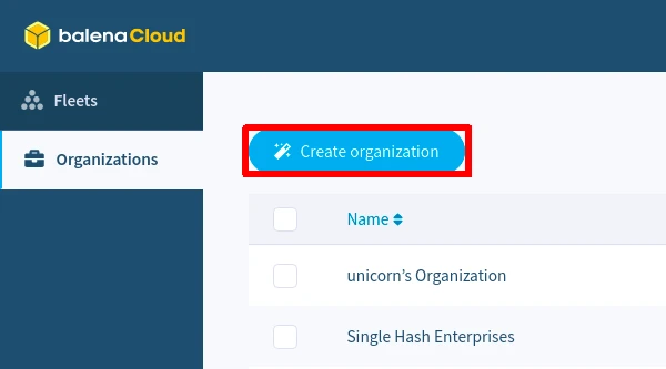

To create a new organization, navigate to your balenaCloud dashboard and click the `Organizations` tab on the sidebar.
<figure><img src="https://3346268949-files.gitbook.io/~/files/v0/b/gitbook-x-prod.appspot.com/o/spaces%2F8MXngJ2SifhuKl2pgGbI%2Fuploads%2Fgit-blob-1671e83e543c4ea4f802c738098740f7ebde9e78%2Forganizations_tab.webp?alt=media" alt=""><figcaption></figcaption></figure>
Next, click the `Create Organization` button to get the create organization modal below. Fill in the name of your organization, and you are all set. This is also the page where you can check all organizations that you have access to. The user creating an organization is, by default, given administrator access to that organization.

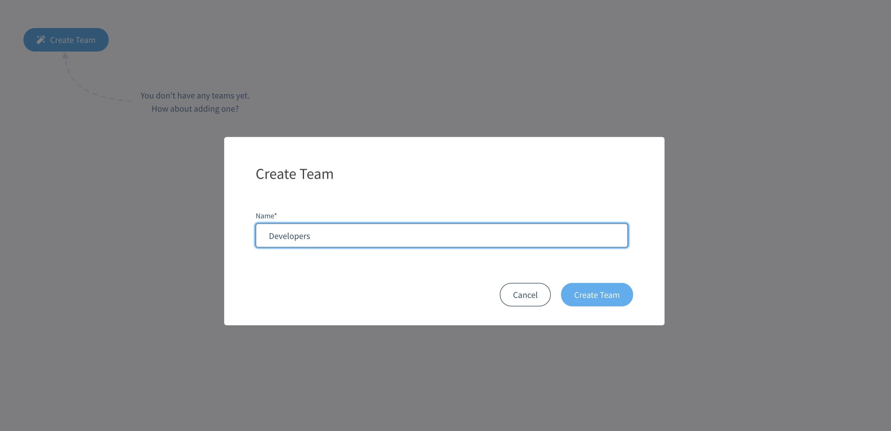

To create a team, navigate to the `Teams` page via the sidebar and click the `Create Team` button. In the create team modal, enter the team name being created and click the `Create Team` button.

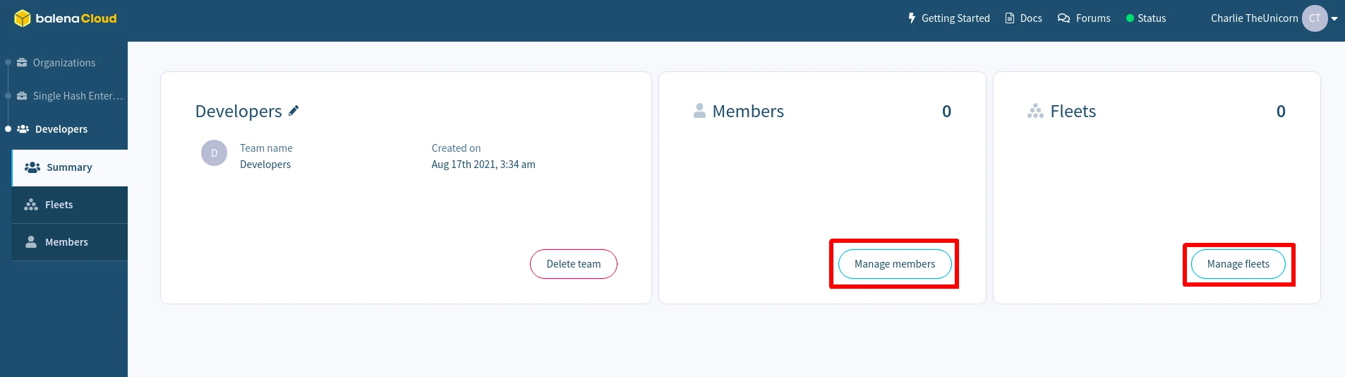

Once the team is created, add members or grant the team access to fleets by clicking on the `Manage members` and `Manage fleets` buttons, respectively.

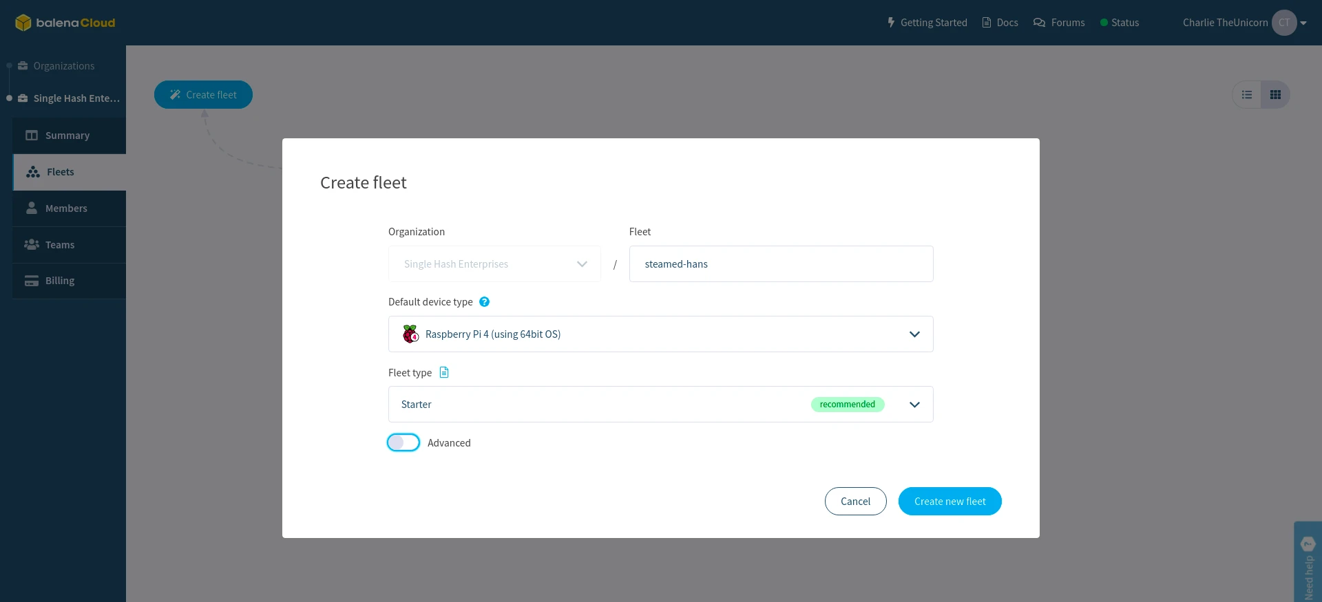

## Creating new fleets under your organization
With members invited to the organization, let's get started on creating new fleets under an organization. Navigate to the `fleets` tab in the sidebar (under the correct Organization if you have multiple ones) to find the `Create fleet` button for creating a new fleet under your organization. Learn more about creating a fleet from the [getting started](/learn/getting-started.md) guide.

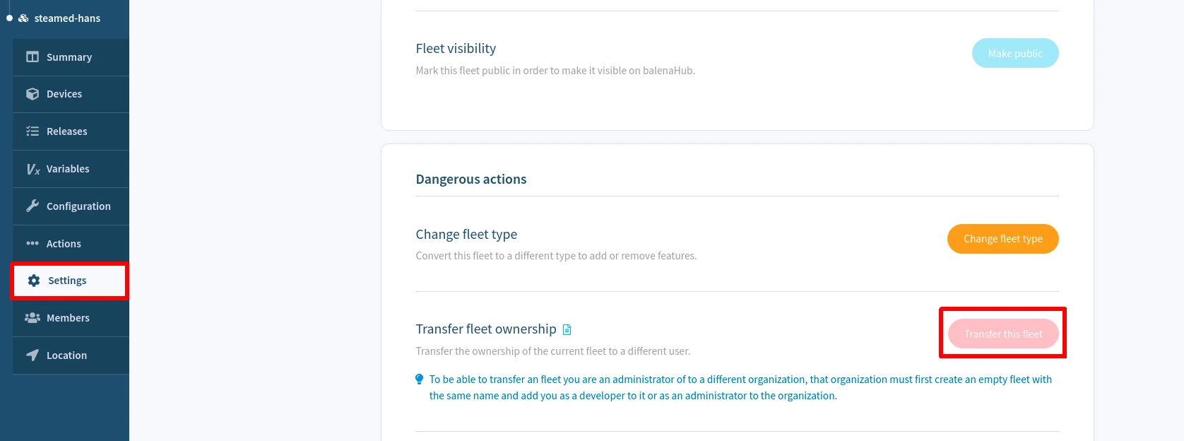

### Moving existing fleets to an organization
Moving an existing fleet to an organization is a common task accomplished by [transferring ownership](/learn/manage/actions.md#transfer-fleet-ownership) of your fleet.

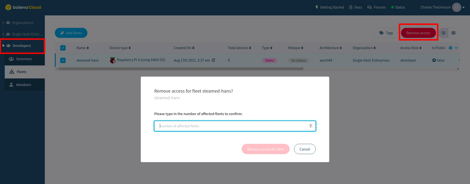

Alternatively to **remove access** to fleets, for individual members or teams, you can navigate back to the respective summary page of the member or team and click the `Manage fleets` button there. From the fleet list, check the checkboxes for the relevant fleets and click the `Remove access` button at the top of the page.
