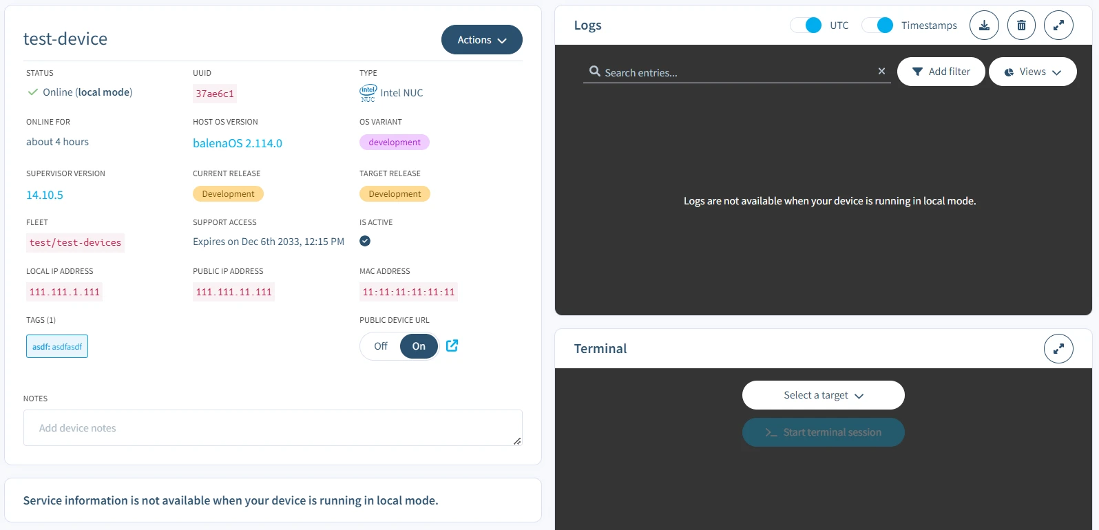

  • Local mode must be enabled through the balenaCloud dashboard. You can enable it from the device Settings tab.

  • In local mode, a device will not send logs back to the balenaCloud dashboard. Refer to the local mode logs section to view logs in local mode.
