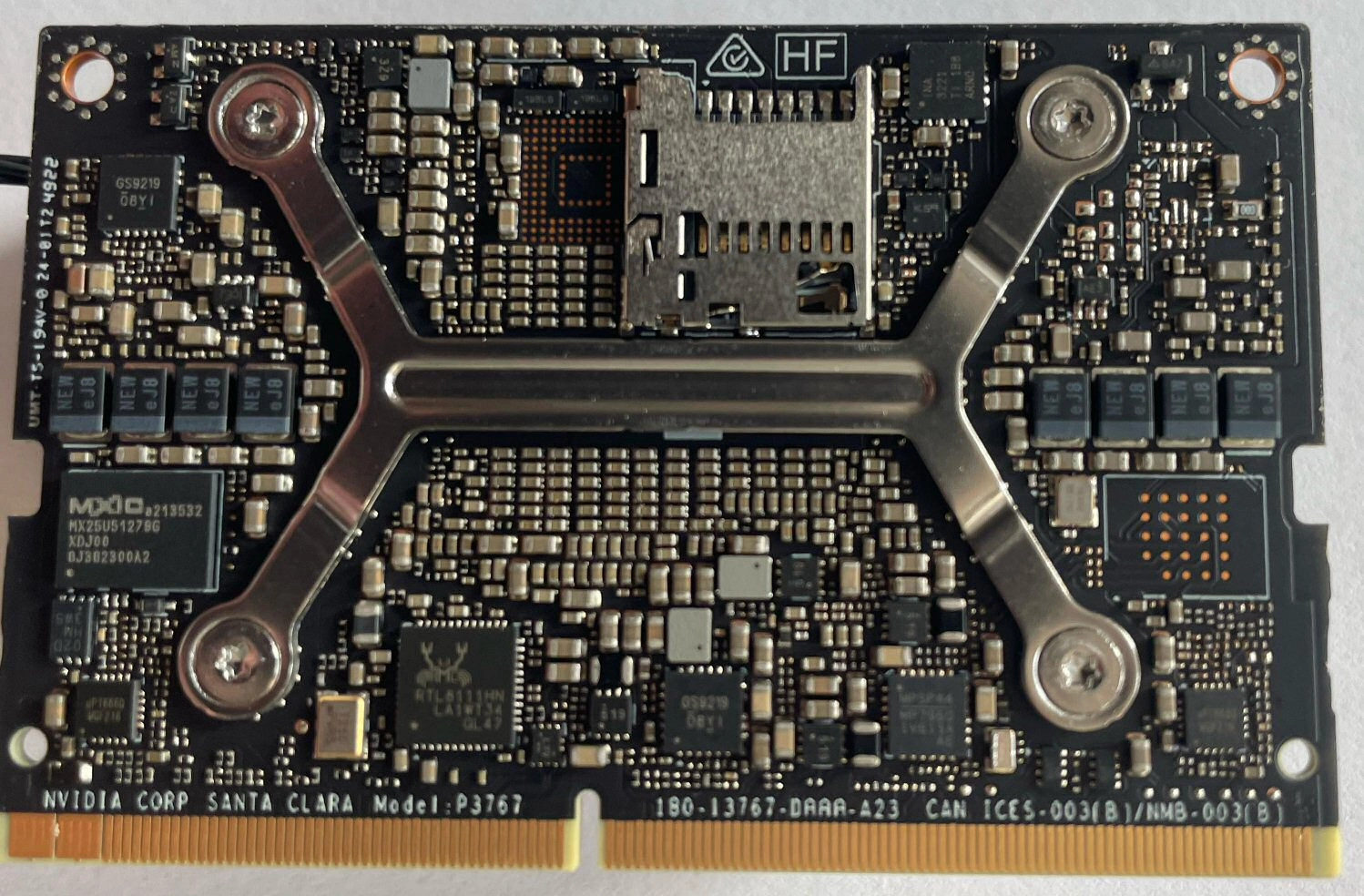

The Orin Nano 8GB SD module has the part number 900-13767-0050-000. This number may not be printed on some modules, however, the part can be distinguished by having an SD-CARD slot.

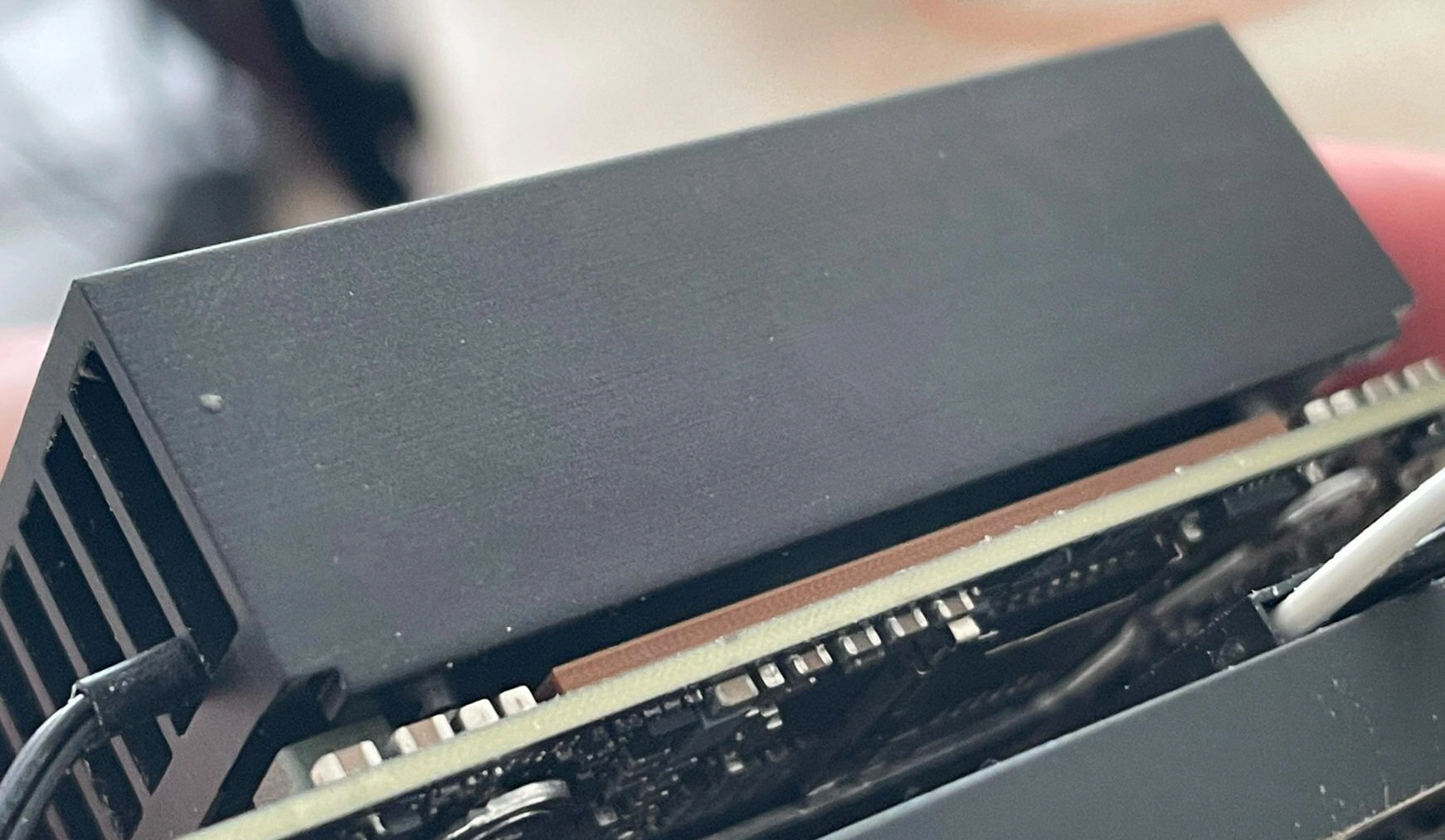

The carrier board exposes a debug interface on the UART TXD, UART RXD and GND pins, which are located underneath the Orin module. Additionally, a monitor can be connected to the board's Display Port.
