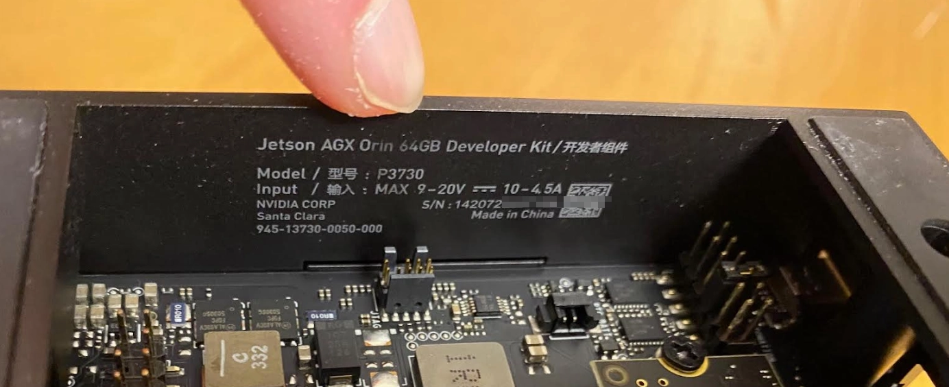

The Nvidia Jetson AGX Orin 64 GB development kit has a label on the inside bottom as shown. It mentions part number 945-13730-0050-000 and reads “Jetson AGX Orin 64GB Developer Kit”.
