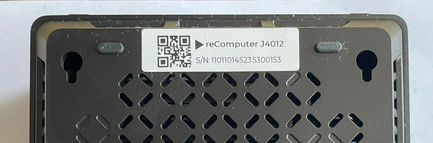

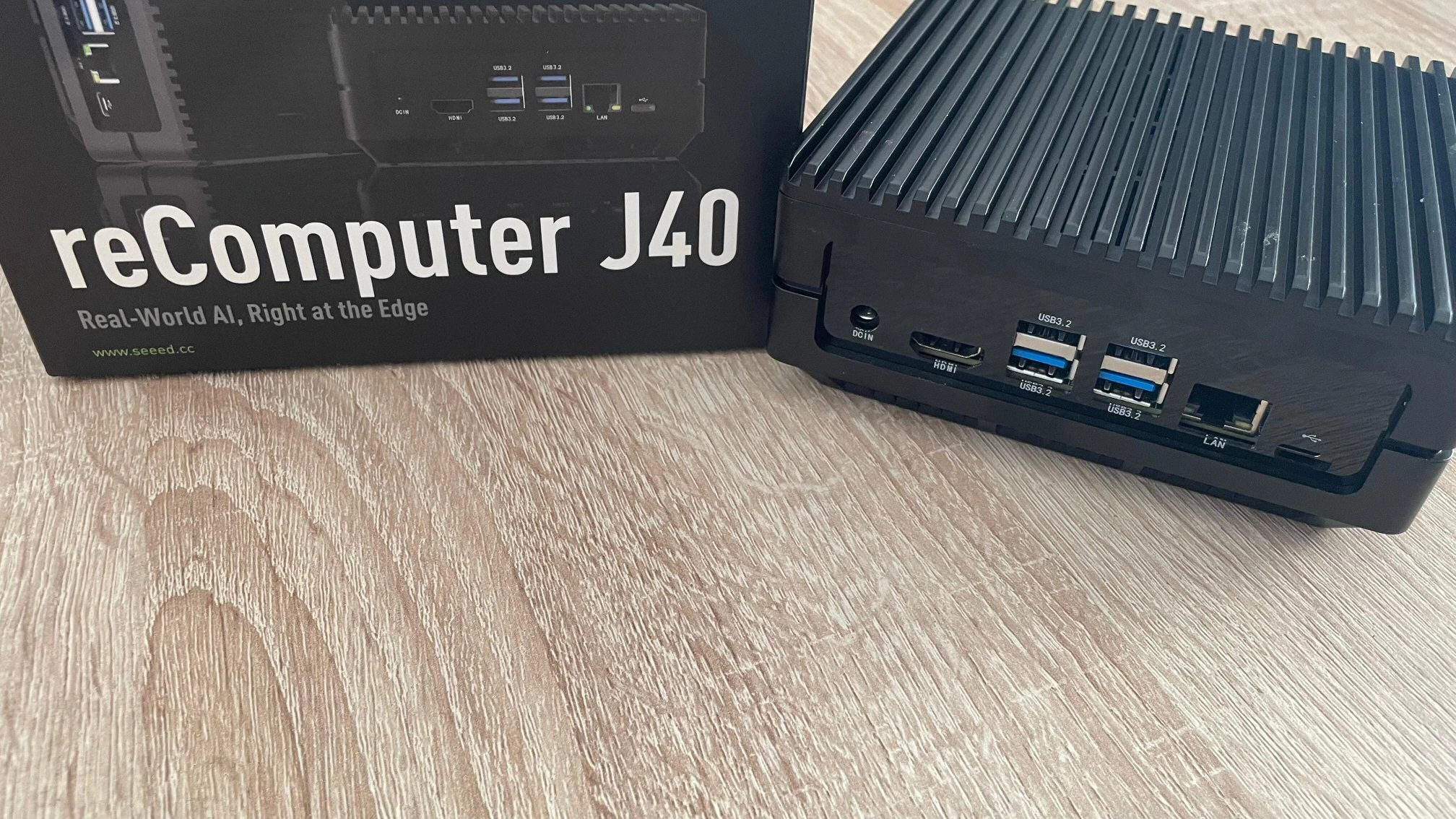

The device has the Seeed Studio logo on the back, and the following sticker on the bottom:
<figure><img src="https://3346268949-files.gitbook.io/~/files/v0/b/gitbook-x-prod.appspot.com/o/spaces%2F8MXngJ2SifhuKl2pgGbI%2Fuploads%2Fgit-blob-c512e5c2fe7a04092c5177672f5ccea85e02052f%2FJ4012_case.webp?alt=media" alt=""><figcaption></figcaption></figure>
The SOM in the Seeed reComputer J4012 is a Jetson Orin NX 16GB, which has the part number 900-13767-0000-000. The J401 carrier board exposes a debug interface on the UART TXD, UART RXD and GND pins, which are located underneath the Orin NX SOM. Additionally, a monitor can be connected to the board's HDMI Port.

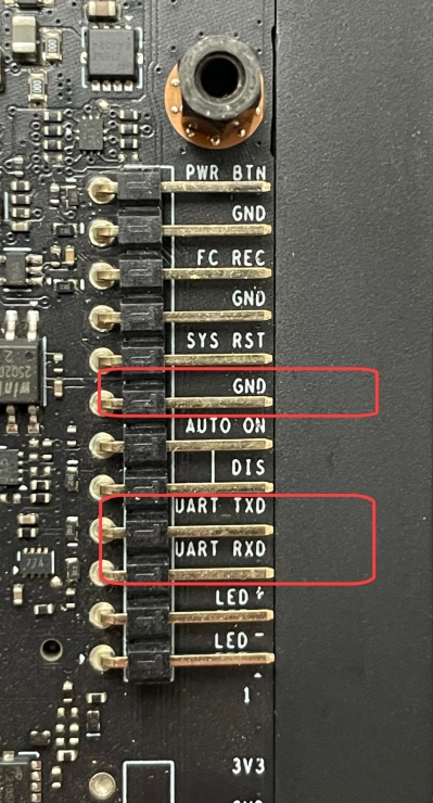

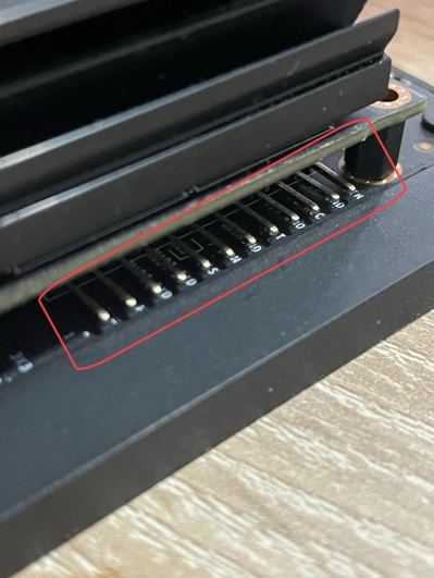

For this step you will need a USB to TTL converter cable. The USB to TTL converter's pins need to be connected to the UART TXD, UART RXD and GND pins on the Jetson carrier board, which are located underneath the Orin module. The other end of the cable should be plugged into the USB port of your host/development PC. Your host PC can connect to the Jetson device using a serial communication program like `minicom`
<figure><img src="https://3346268949-files.gitbook.io/~/files/v0/b/gitbook-x-prod.appspot.com/o/spaces%2F8MXngJ2SifhuKl2pgGbI%2Fuploads%2Fgit-blob-f81a5e69d7afb247022bfff89a137bceac44c663%2FNano_pinout_with_module_square.webp?alt=media" alt=""><figcaption></figcaption></figure>
<figure><img src="https://3346268949-files.gitbook.io/~/files/v0/b/gitbook-x-prod.appspot.com/o/spaces%2F8MXngJ2SifhuKl2pgGbI%2Fuploads%2Fgit-blob-7dd2591e2caf58bd85b0ddcd5a096f049fbcaf0d%2FNano_pinout_close_square.webp?alt=media" alt=""><figcaption></figcaption></figure>

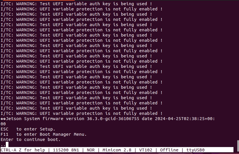

If you are using the UART interface, the UEFI firmware version will be printed in the boot sequence logs:

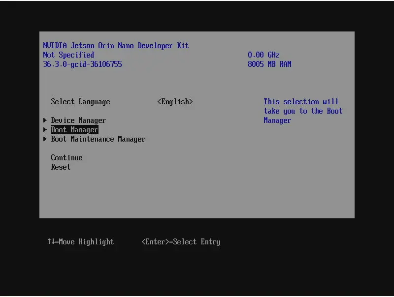

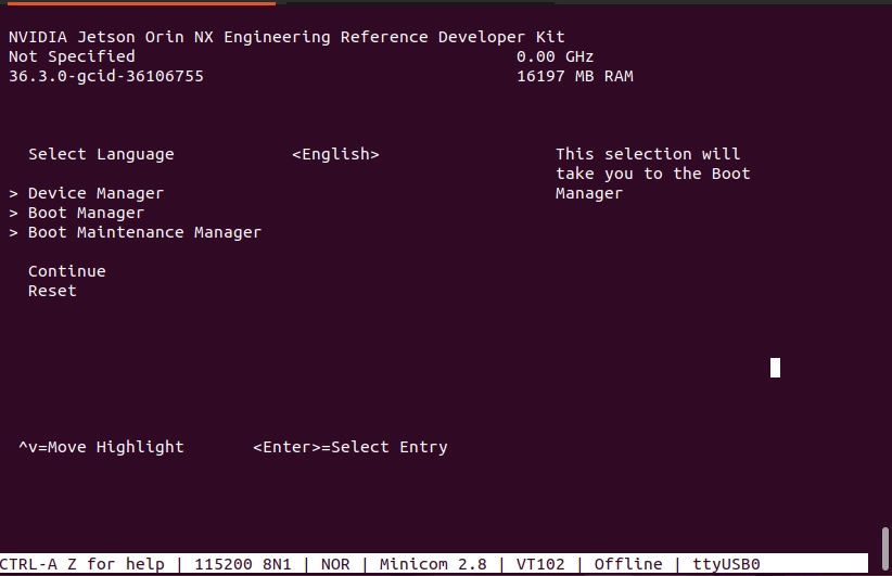

<figure><img src="https://3346268949-files.gitbook.io/~/files/v0/b/gitbook-x-prod.appspot.com/o/spaces%2F8MXngJ2SifhuKl2pgGbI%2Fuploads%2Fgit-blob-4a1633d1412bcb5a9c1419e79c15f88a5c0806ab%2Fjetson_orin_uefi_version_uart_logs.webp?alt=media" alt=""><figcaption></figcaption></figure>
Alternatively, if booting is stopped in the UEFI menu by pressing `Esc`, the firmware version will be printed in the top-left corner:
<figure><img src="https://3346268949-files.gitbook.io/~/files/v0/b/gitbook-x-prod.appspot.com/o/spaces%2F8MXngJ2SifhuKl2pgGbI%2Fuploads%2Fgit-blob-7cdef27caec1a96f6f8ee54128b045f41f4fbd98%2Fjetson_orin_uart_uefi_menu.webp?alt=media" alt=""><figcaption></figcaption></figure>

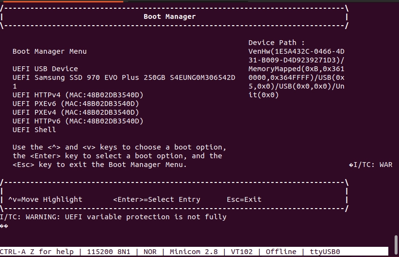

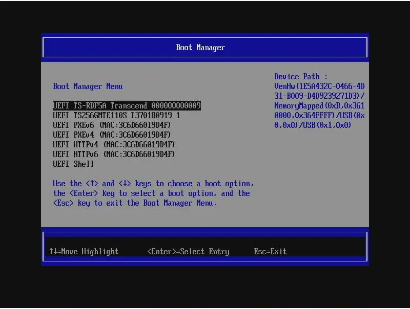

2. Power on the device and press `Esc` when prompted by the UEFI firmware, or `F11` to enter the Boot Manager Menu directly:
<figure><img src="https://3346268949-files.gitbook.io/~/files/v0/b/gitbook-x-prod.appspot.com/o/spaces%2F8MXngJ2SifhuKl2pgGbI%2Fuploads%2Fgit-blob-f24260b8ddbc849927f0d99ecd4df3c63a7732c0%2Finterrupt_boot_uart.webp?alt=media" alt=""><figcaption></figcaption></figure>
If `Esc` was pressed, navigate to the Boot Manager Menu:
<figure><img src="https://3346268949-files.gitbook.io/~/files/v0/b/gitbook-x-prod.appspot.com/o/spaces%2F8MXngJ2SifhuKl2pgGbI%2Fuploads%2Fgit-blob-839945ad492520b0c2d39f74cc8aa503474eb5b9%2Fboot_manager_uart.webp?alt=media" alt=""><figcaption></figcaption></figure>
3. Select the attached USB device as boot media:
<figure><img src="https://3346268949-files.gitbook.io/~/files/v0/b/gitbook-x-prod.appspot.com/o/spaces%2F8MXngJ2SifhuKl2pgGbI%2Fuploads%2Fgit-blob-cf86edb0480f991b47314ca80f64e705d44b162c%2Fusb_device.webp?alt=media" alt=""><figcaption></figcaption></figure>
4. Your device should boot from the attached USB flash drive and provision the internal storage. Once provisioning is complete and the device shuts down, the USB flash drive can be unplugged.

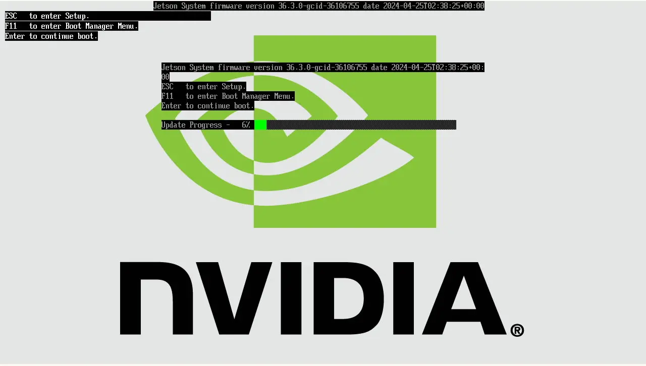

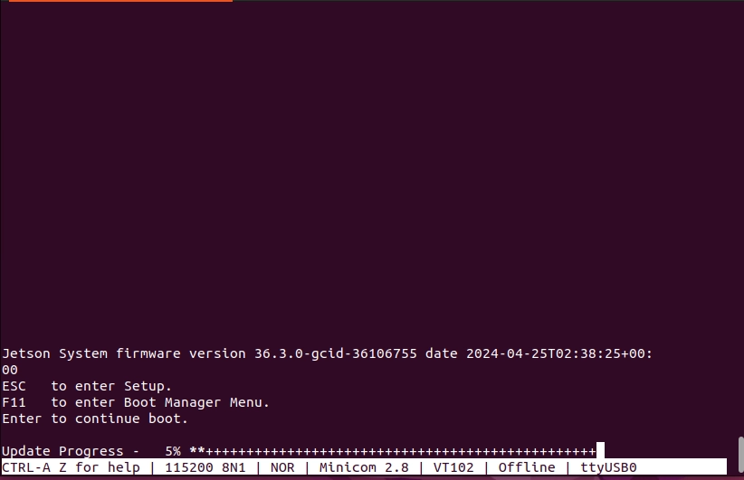

Once your device has been provisioned with balenaOS and powered back-on, it will attempt to update the UEFI firmware automatically. The status of the UEFI firmware update process is depicted by a progress bar on the debug UART interface, as well on the display, if connected.
Do not interrupt the UEFI firmware process by resetting or cutting power to the device.
If you are using the debug UART, the firmware update process will be displayed by a progress bar similar to the one below:
<figure><img src="https://3346268949-files.gitbook.io/~/files/v0/b/gitbook-x-prod.appspot.com/o/spaces%2F8MXngJ2SifhuKl2pgGbI%2Fuploads%2Fgit-blob-a304fa37e704632329ec767e2f5659f79df8f29f%2Fpost_provisioning_uefi_firmware_update.webp?alt=media" alt=""><figcaption></figcaption></figure>
If a display is connected to the device, the firmware update process will also be rendered on the screen:
