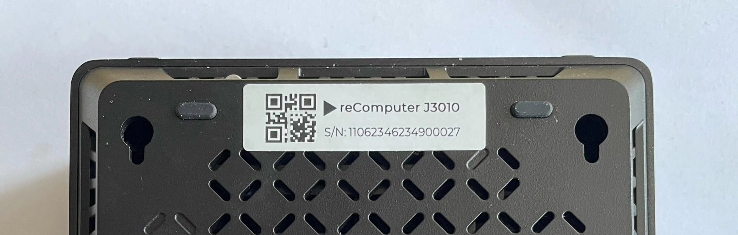

The device has the Seeed Studio logo on the back, and the following sticker on the bottom:
<figure><img src="https://3346268949-files.gitbook.io/~/files/v0/b/gitbook-x-prod.appspot.com/o/spaces%2F8MXngJ2SifhuKl2pgGbI%2Fuploads%2Fgit-blob-37aa5a0ec62964a1431b8198fec761f4c81056eb%2FJ3010_case.webp?alt=media" alt=""><figcaption></figcaption></figure>

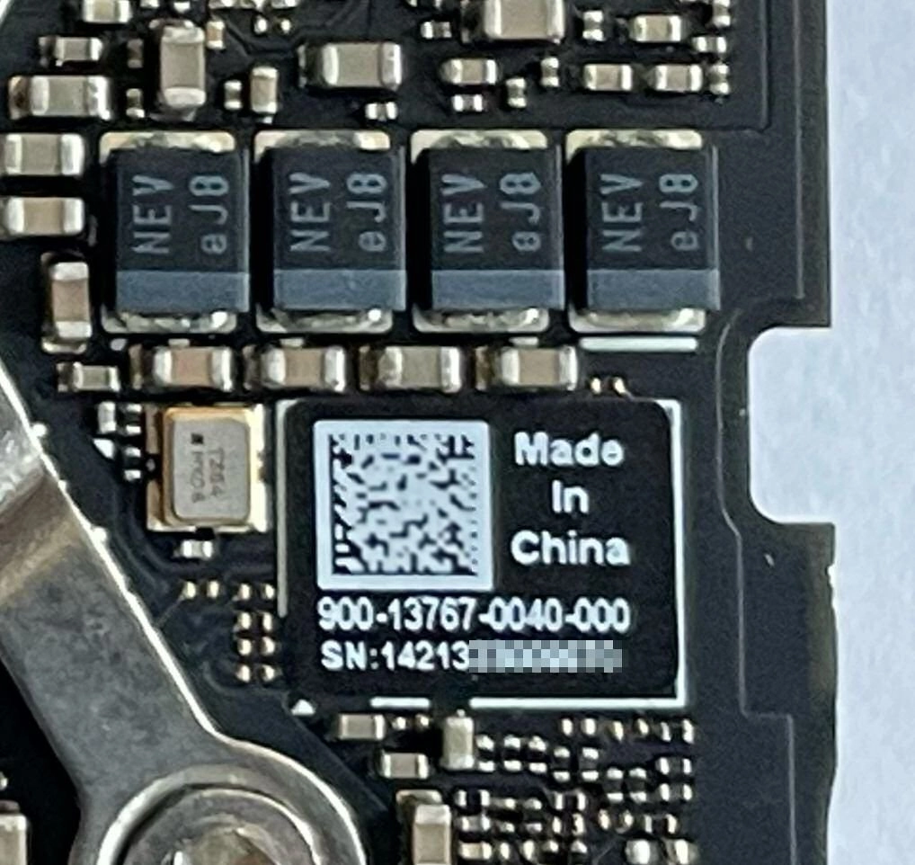

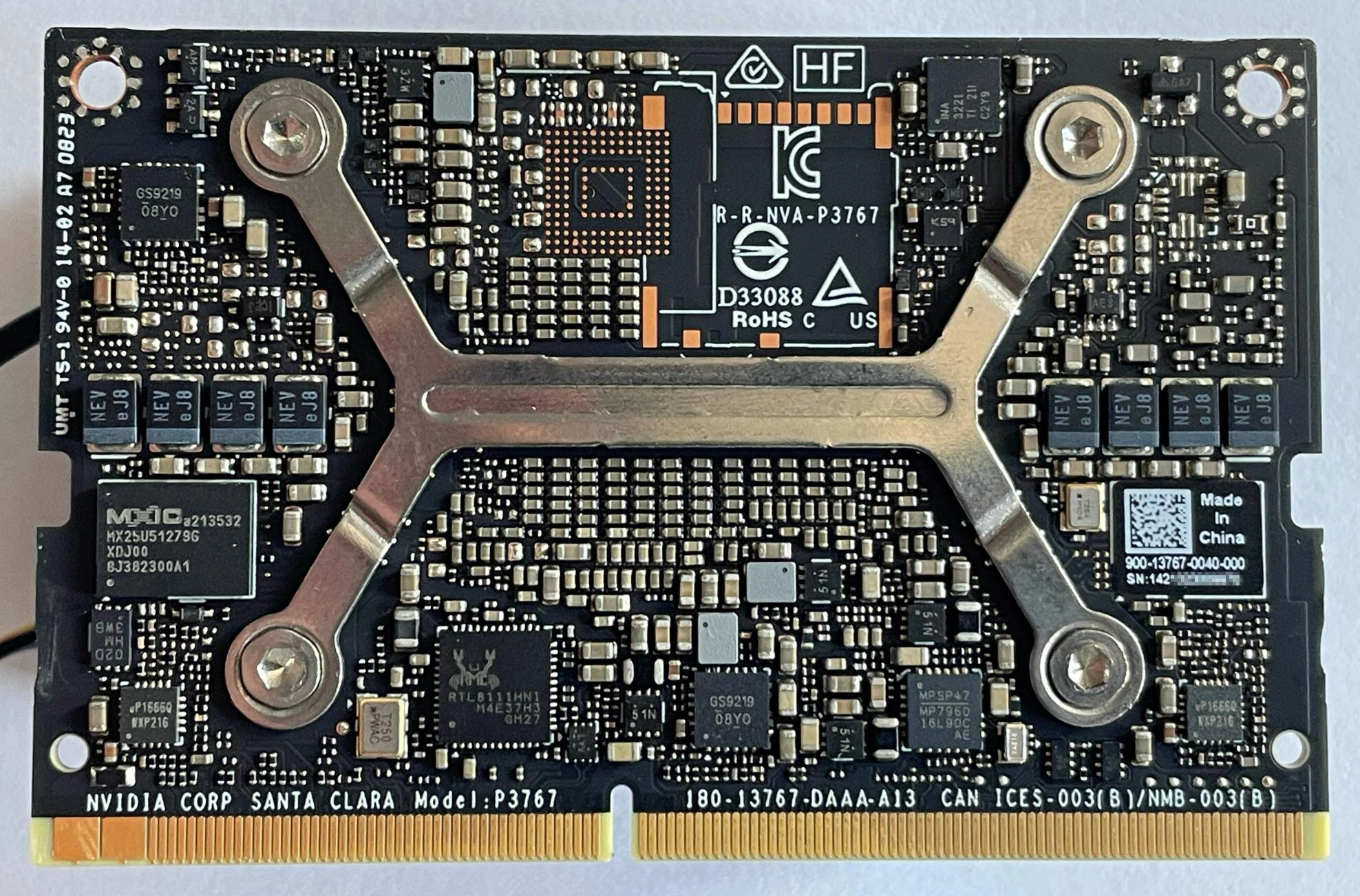

The SOM in the Seeed reComputer J3010 is a Jetson Orin Nano 4GB, which has the part number 900-13767-0040-000. This part number can be found on the bottom of the SOM, if it is taken out of the carrier board:
<figure><img src="https://3346268949-files.gitbook.io/~/files/v0/b/gitbook-x-prod.appspot.com/o/spaces%2F8MXngJ2SifhuKl2pgGbI%2Fuploads%2Fgit-blob-fc3cd331f20f9a3f457effad266bf7b5c5bf375c%2FNano_4GB_SOM_900-13767-0040-000.webp?alt=media" alt=""><figcaption></figcaption></figure>
<figure><img src="https://3346268949-files.gitbook.io/~/files/v0/b/gitbook-x-prod.appspot.com/o/spaces%2F8MXngJ2SifhuKl2pgGbI%2Fuploads%2Fgit-blob-94645b454e591de44c679b9203f7565b585320d3%2FNano_4GB_SOM_900-13767-0040-000_closeup.webp?alt=media" alt=""><figcaption></figcaption></figure>
