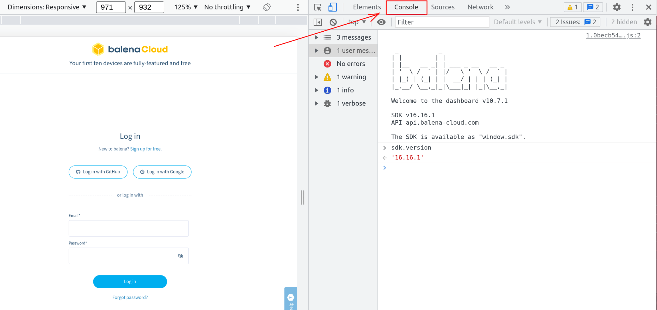

## Trying balenaSDK in the browser
BalenaSDK is widely utilized in the [balenaCloud dashboard](https://dashboard.balena-cloud.com/) to perform operations. The SDK has been made available in the browser console by default to test balenaSDK queries on the go. To use it, head to the [balenaCloud dashboard](https://dashboard.balena-cloud.com/) and open the [browser developer console](https://support.monday.com/hc/en-us/articles/360002197259-How-to-Open-the-Developer-Console). There, you will find balenaSDK initialized in the console and ready to run SDK queries.
![](https://user-images.githubusercontent.com/22801822/157650701-d47ee5bc-28e4-4ca9-9aba-e208d47698c3.png)
