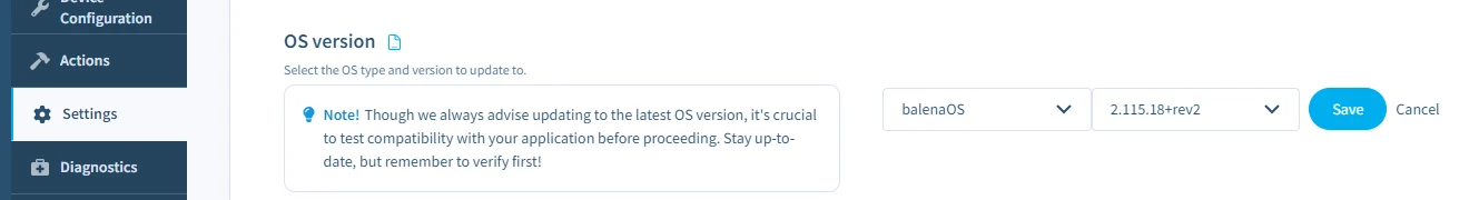

To run an update for an individual device, navigate to that device's *Settings* tab, go to the section *OS version*, and select the version of balenaOS you would like to update to. After making your selection, click the *Save* button.

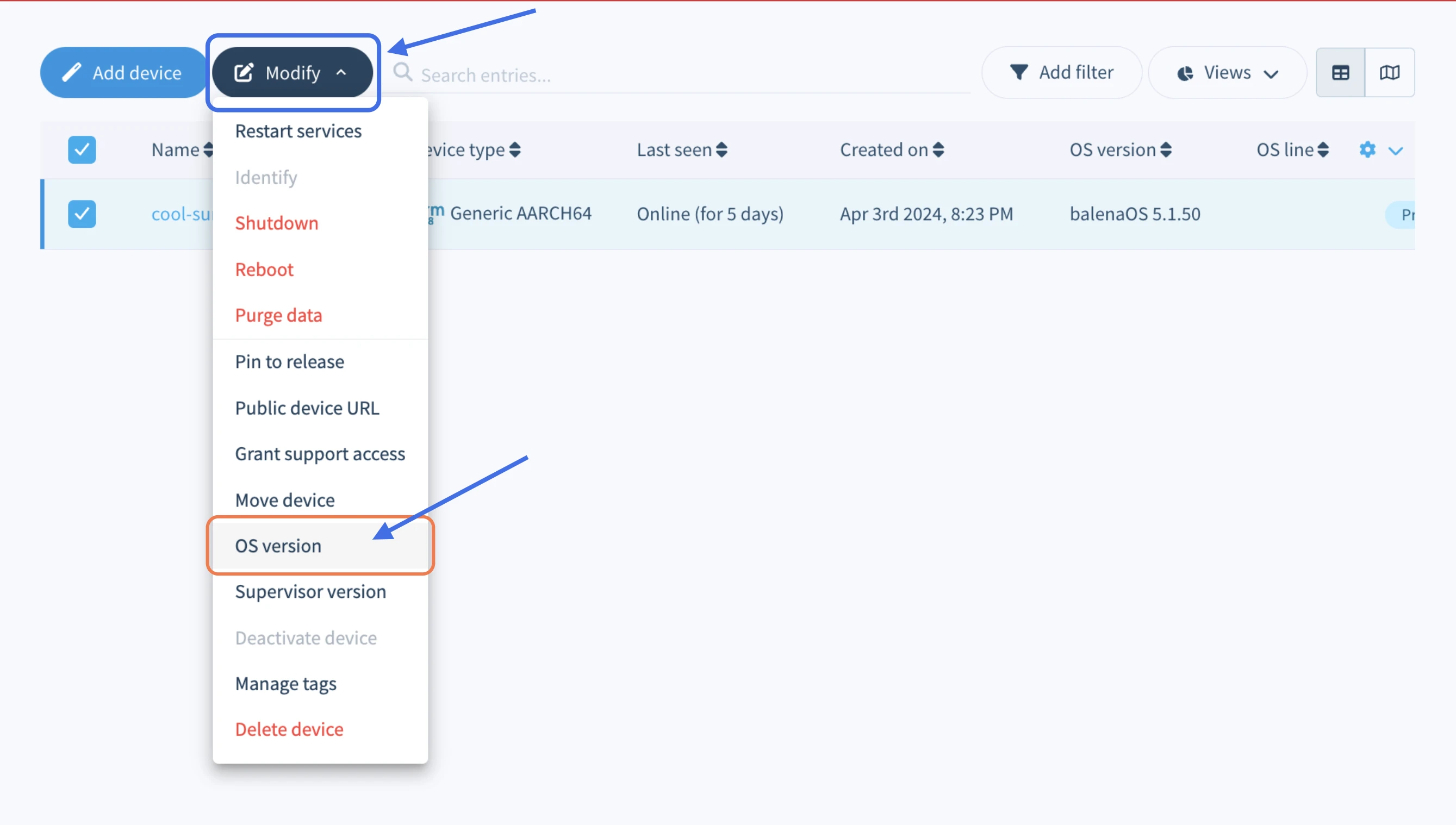

Updates can also be made to multiple devices in the same fleet. From the device list, click the checkbox to the left of any devices you wish to update. Then use the *Modify* dropdown to choose the *OS version* option to set and trigger an update on all selected devices.

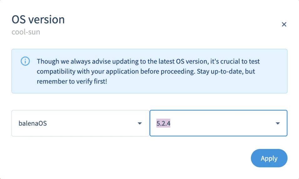

From the dialog box that opens, select the desired OS version and click the `Update` button to queue the update.
