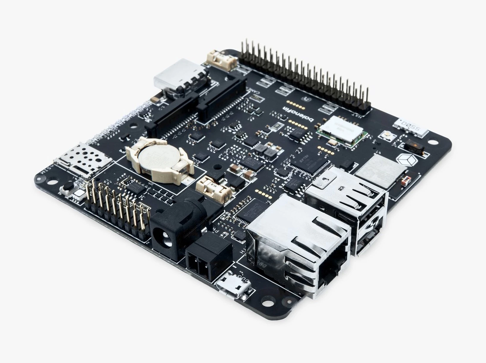

What you'll need
  • A Balena Fin. See our supported devices list for other boards.
