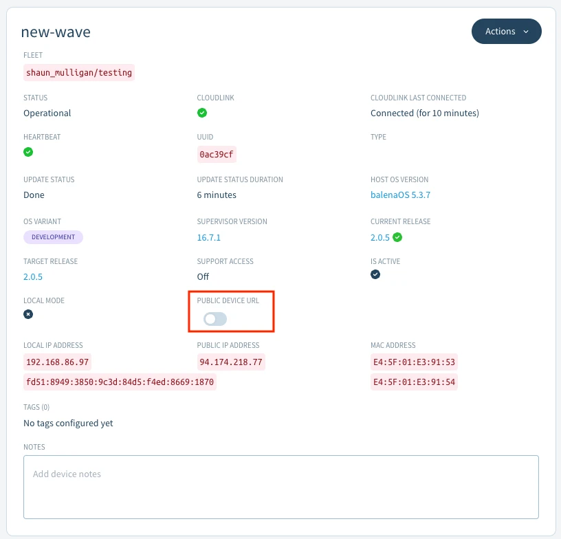

### Public device URLS
Balena currently exposes port 80 for web forwarding. To enable web forwarding on a specific device, navigate to the device's **actions** tab on the balenaCloud dashboard and select the `Enable a public URL for this device` button. For more information about device URLs see the [Device Management Page](https://docs.balena.io/learn/manage/actions.md#public-device-url)
<figure><img src="https://3346268949-files.gitbook.io/~/files/v0/b/gitbook-x-prod.appspot.com/o/spaces%2F8MXngJ2SifhuKl2pgGbI%2Fuploads%2Fgit-blob-10f33584117e48a8fc107375a0bfca684945e0e0%2Fenable-public-url-device.webp?alt=media" alt=""><figcaption></figcaption></figure>
Running a server listening on port 80 with public device URL enabled will allow you to serve content from the device to the world. Here is an example of an [express.js](https://expressjs.com/) server which will serve to the devices URL.
