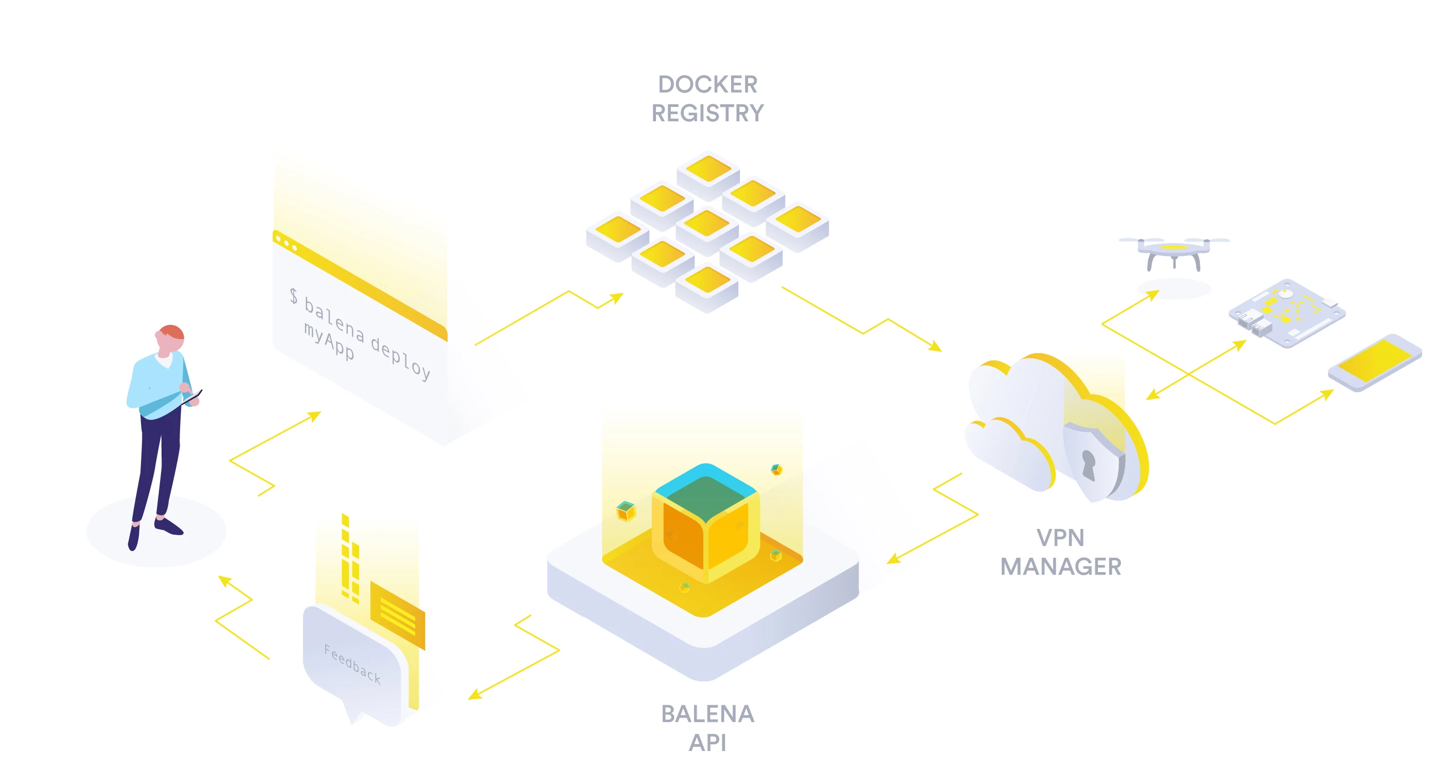

When you run the `balena push <APP_NAME or DEVICE_IP>` command from your laptop it will essentially take your project (or repository) folder, compress it and send it to the [balenaCloud build server](#the-balenacloud-build-server) or local balenaOS device in [localMode](https://docs.balena.io/learn/develop/local-mode.md) where it will be built.
<figure><img src="https://3346268949-files.gitbook.io/~/files/v0/b/gitbook-x-prod.appspot.com/o/spaces%2F8MXngJ2SifhuKl2pgGbI%2Fuploads%2Fgit-blob-7e7c3dd270131b304539ac5612f743d5d1716444%2Fbalena-push.webp?alt=media" alt=""><figcaption></figcaption></figure>
Once the cloud builder has successfully completed building all the images in the deployment, it will upload these images to the balenaCloud registry and create a release entry in the [balena API](https://docs.balena.io/reference/api/overview.md) database. It will then notify all the devices in the fleet that a new release is available. If you need to pull in proprietary code or use a private base image during your builds, you can do so using the [build time secrets](#build-time-secrets-and-variables) or [private base images](#private-base-images) feature of `balena push`.
It should be noted that `balena push` is independent of git, so you are free to use any version control system you wish. This also means that it is possible to use [git submodules](https://git-scm.com/book/en/v2/Git-Tools-Submodules) in your project when deploying with `balena push`.

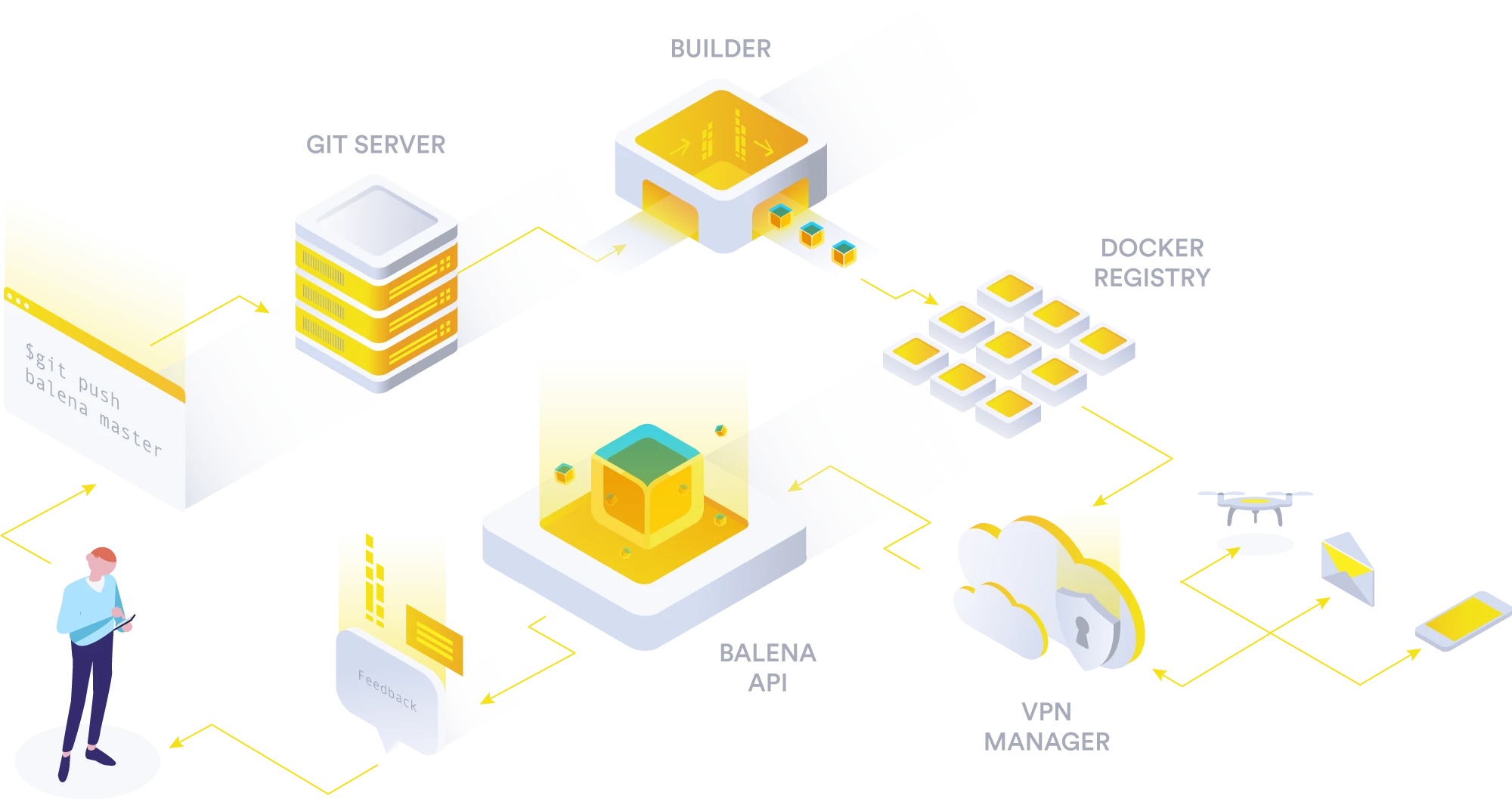

The `git push balena master` method of deployment is the original deployment mechanism for balenaCloud. While we continue to support git push, it is considered a legacy method for pushing code to a fleet, and if possible you should use [balena push](#balena-push) as it makes for a consistent workflow and methodology.
The `git push` workflow requires that you have [git](https://git-scm.com/) installed on your development machine and that you have an SSH key [setup on your balenaCloud account](https://docs.balena.io/learn/manage/ssh-access.md).
<figure><img src="https://3346268949-files.gitbook.io/~/files/v0/b/gitbook-x-prod.appspot.com/o/spaces%2F8MXngJ2SifhuKl2pgGbI%2Fuploads%2Fgit-blob-7f325f4c3602e7d9b2cfc7234fce950e2e2da183%2Fgit-push.webp?alt=media" alt=""><figcaption></figcaption></figure>
Then, simply add your balenaCloud app's git endpoint to your local git repository via `git remote add balena <fleet git endpoint>` . You can find the fleet git remote endpoint by clicking the 'Add release' button in the releases tab of the dashboard.
<figure><img src="https://3346268949-files.gitbook.io/~/files/v0/b/gitbook-x-prod.appspot.com/o/spaces%2F8MXngJ2SifhuKl2pgGbI%2Fuploads%2Fgit-blob-920a7c7f3b5fc6f2584be6ffc19ba33016a71a28%2Fgit-remote.webp?alt=media" alt=""><figcaption></figcaption></figure>
Whenever you subsequently need to push code to your devices, simply run `git push balena master`.

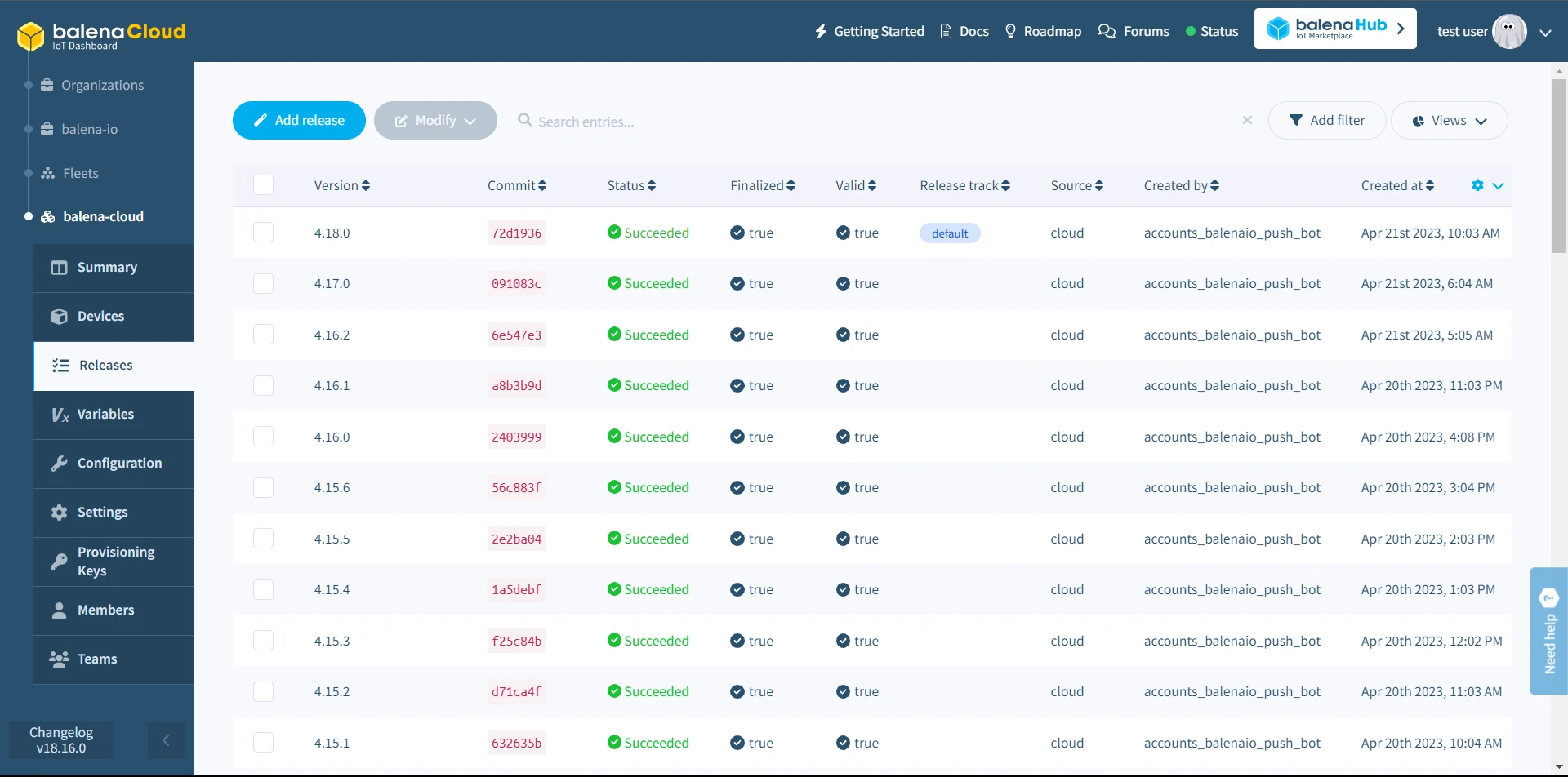

All successful deployments will result in a release being added to balenaCloud. These releases are tracked in their own dashboard page accessed via the fleet:
<figure><img src="https://3346268949-files.gitbook.io/~/files/v0/b/gitbook-x-prod.appspot.com/o/spaces%2F8MXngJ2SifhuKl2pgGbI%2Fuploads%2Fgit-blob-8f8bca6acdfb19974baf9787ba86fe6090271115%2Frelease_list.webp?alt=media" alt=""><figcaption></figcaption></figure>
The releases page includes a list of all attempted and deployed releases, with information on the status of the release, when it was completed, how long it took, and how many devices are on that particular release. Clicking any row will open up a summary page specifically for that release, with windows showing the `docker-compose.yml` file and Build Logs:
<figure><img src="https://3346268949-files.gitbook.io/~/files/v0/b/gitbook-x-prod.appspot.com/o/spaces%2F8MXngJ2SifhuKl2pgGbI%2Fuploads%2Fgit-blob-0b5faa5517ce0108bde3c3b109f5737022d7aa86%2Frelease_summary.webp?alt=media" alt=""><figcaption></figcaption></figure>
