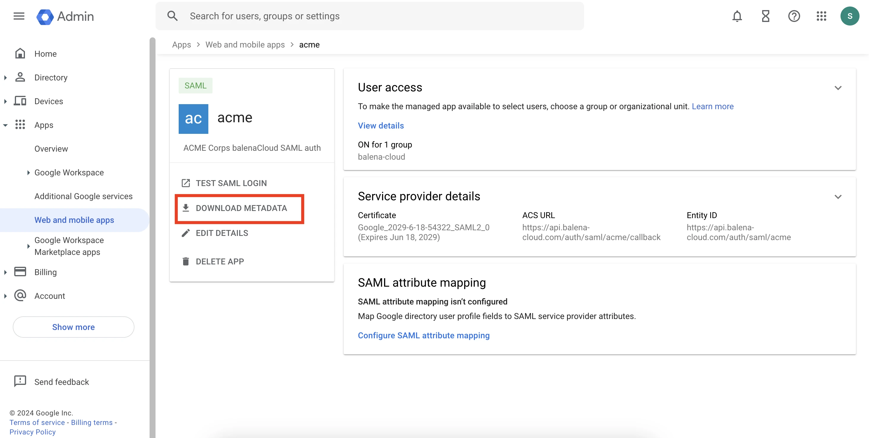

7. Finally, you should a custom SAML app in your Google Workspace that looks similar to this
<figure><img src="https://3346268949-files.gitbook.io/~/files/v0/b/gitbook-x-prod.appspot.com/o/spaces%2F8MXngJ2SifhuKl2pgGbI%2Fuploads%2Fgit-blob-50cc7b5009f3f37813ee4ca9ac8cfe6412c75f1b%2Fgoogle-workspace-saml-app-final.webp?alt=media" alt=""><figcaption></figcaption></figure>
